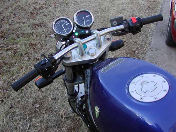

Here is my $11.50 "quickie mod"
Remove Old bars and chunk em...
Buy a set of standard 7/8" Diameter drag bars.
Remove Clamps from top of tree and Turn arround shimming with Fender washers. The washers sit between the top of the tree and the bottom of the riser clamps, you only need about 3/8" max rise.
Install the Drag Bars and realize why you had to shim the riser clamps. (the bars miss the top of the fork tubes by 1/16").
Mark and drill holes for your controls.
Reroute the cables so as noting is binding or crimped.
Ye- haw, there you go!! Cheap and it gives you a nice riding position.
The future goal for this project mz is to custom machine a top tree that
has mounts built in for carbon fiber handlebar tubes....Way freekin sweet!
Here are the pics, let me know what you all think out there... :D
Kelly

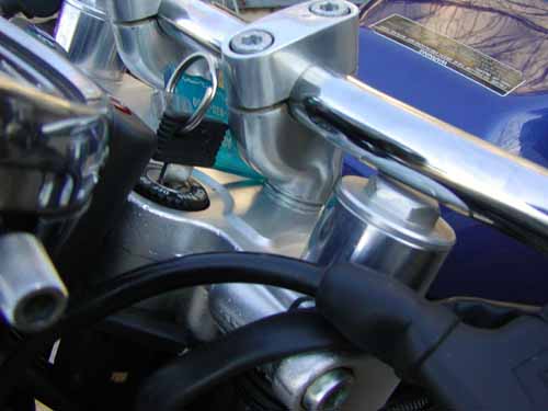

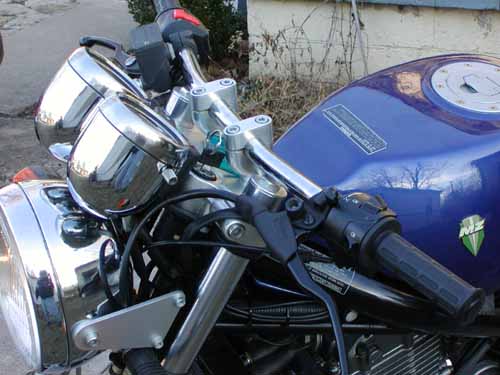

Postby mcmoto » Sun Jan 30, 2005 1:41 pm
Here's a couple more views... :shock:
Whith the rearsets in the race position the bars make this bike
handle soooo much better than stock....
...Cant wait for the machined / carbon setup. :twisted:
Kelly
