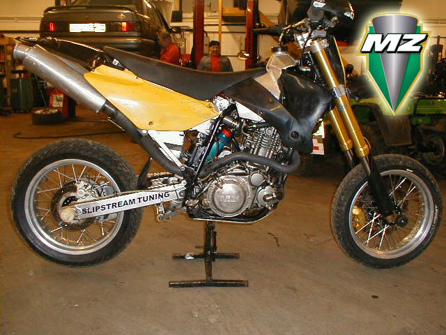

harold wrote:Bill gave me some good advice on my single Mikuni mod. The Grizzly manifold has the ports closer together than our head, thus needing an adapter of some kind. On the Baghira, there isn't room for the carb, so I had to cut a frame member and mount the carb around 6" back from the head where the air box used to be. It works and jetting is now simple and available. Niether were true with the stock carbs. If you search on my posts, you will see how I did it, and it won't take that long to find them. It looks like it would be quite a bit simpler on a Scorpion.
Harold,
Thought of this picture posted some time ago.
OMC

OMC,
Now that is what I call, highly modified, from one end to the other. By the way, if you want to see some negative ads right now, just come to Florida. Every other commercial on TV.

Postby basser23 » Mon Jan 30, 2012 12:09 pm
that is Wonky's bike in progress a few years back. Know as "STMZ" highly modified,as Wonky used to work at Splistream Tuning.
A true monster machine...MCN tested it years back...
