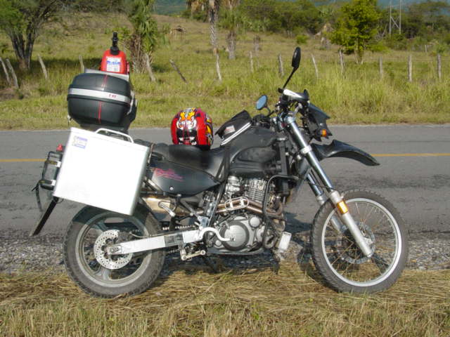

Postby DEmark » Fri Feb 04, 2005 10:39 pm
Yes, I travel a lot, I put 21000 miles on my Baghira in the first year I had it. That picture was taken in Veracruz Mexico. I rode my Skorpion all the way to Belize in 2002.

Postby keithcross » Sat Feb 05, 2005 3:54 am
Looking at the picture of your bike it looks like you have an oil cooler fitted low down at the front. If it is an oil cooler does it seem to make any difference.

Postby DEmark » Sat Feb 05, 2005 8:07 am
It's a toolbox, it works pretty well. There is a better picture in the album section and a short evaluation, let your cursor float over the picture to see the text. I'm going to try to find the time to start a personal album with photos and evaluations on each modification I have made to my Baghira. I am currently fitting a set of 35x35mm flat slide Keihins up. It's proving to be much more difficult than fitting them to the Skorpion. I can't see any reason to put an oil cooler on a 660, the cooling fans rarely come on.
