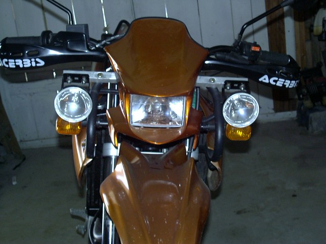

Postby kerry » Sun Feb 06, 2005 4:49 pm
Here's a pic. of how I installed my two 55 watt driving lamps. I used aluminum box stock 3/4"......it fits neatly between the speedo and the headlamp, and is bolted with stainless hardware, to the tube frame that holds the headlamp assy. I then used the mounting brackets that came with the lights to mount them to the box stock. It is very steadfast, and has held up to many offroad adventures. The added light is fantastic, and I think they look cool too!

Postby keithcross » Sun Feb 06, 2005 5:10 pm
The spot lights I used are in a similar position, but teh handle bar clamps used mean I didnt have to drill any bits and they are easily removable for the summer months
