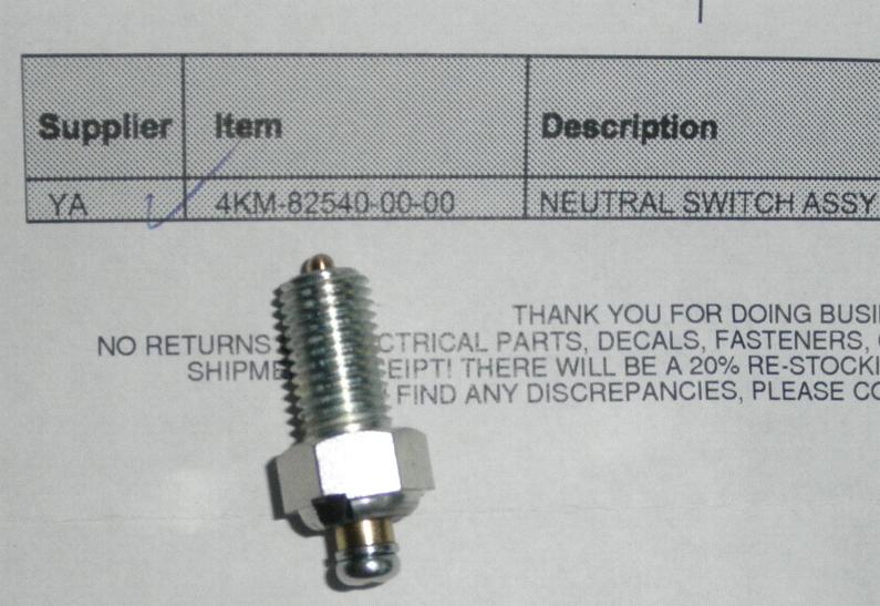

I had found this part number on one post while searching, and then for whatever reason could not locate it again. This one fits a 2002 Baghira, and probably all 660 MZ's, but look at the picture and decide for yourself if it is the same as yours.
Yamaha part # for neutral switch

4KM-82540-00-00
according to the online part list from Yamaha.

Bill,
I posted this more for us in the US, who can not find a XTZ listed since they weren't sold here. Local shops, and online part sellers don't list them. The Raptor uses a different switch, but the Grizzly uses this one, along with about 100 other Yamahas. I almost ordered the wrong one, and thought maybe this could keep someone else from making the same mistake.
