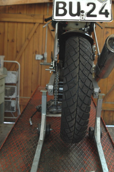

On my green Skorpion mentioned yesterday and talked about on my blog, I have the Haidenau K66 Cup and after 50 miles today, partly in a deluge, I can safely say that they are all they're made up to be: GREAT! Available only in 130/70 which is perfect on my 3,5" rear rim. It will be a safe prediction that they will not last long, however.
TZR-4FL Rad.jpg (69.74 KiB) Viewed 2298 times
It looks like a rain tire, but is purely a supermoto racing tire, not road legal. Doesn't bother me; never has...
