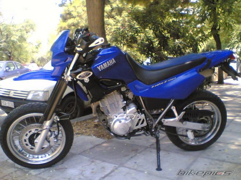

xt600 side shot looks like the sprocket cover is the same as baghira anyone know for definite.. also does the xt600 have its gear shifter straight off the gear shaft ?

Hi Jack. To answer your second question first, yes it does have the gear lever straight off the shaft - and it makes for a much slicker shift than the MZ remote system too!
As for the sprocket cover, I have seen some alloy ones from the same generic engine and they are swappable AFAIK. Certainly nicer than the plastic ones. If I come across one I'll snaffle it just because I like polished alloy - but I'm in no rush, yet.
