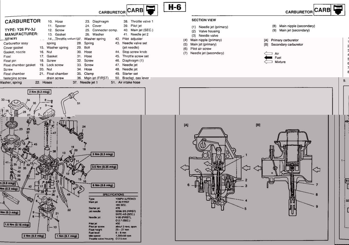

Re: cold starting a problem
Postby Bill Jurgenson » Mon Mar 24, 2008 1:10 pm
That should be the accelerator pump. It has been a long time since I did anything with that carb, save for taking it off the engine.
Here is the relavant page from the Yamaha workshop manual.
Picture 1a.jpg (161.78 KiB) Viewed 3946 times
you are referring to the number 46 behind the small cover number 24, aren't you.

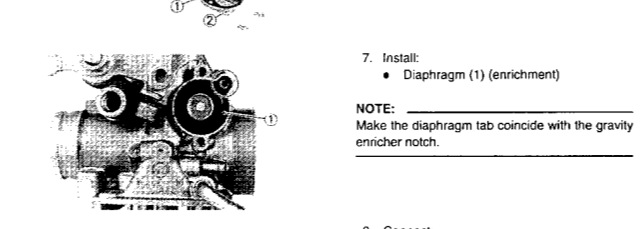

here is what the book says:
Picture 2.jpg (34.51 KiB) Viewed 3946 times
Postby handsomejackuk » Mon Mar 24, 2008 7:43 pm
Bill,
Thats the jobby the diaphragm. not sure what is the right way to fit it. I have put it back in for now but will have to evaluate it when ii come to start bike.... would good to know for definite the correct orientation as its a small item which could make a big difference....
Thanks Bill
