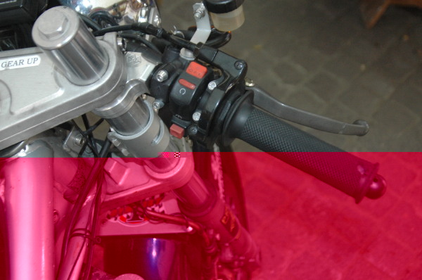

Ducati Griff -Toy.jpg (67.42 KiB) Viewed 6061 times
Gilles GP Light Clipons with that Tommaselli grip, Ducati on/off switch, and Brembo PS16 pump.
