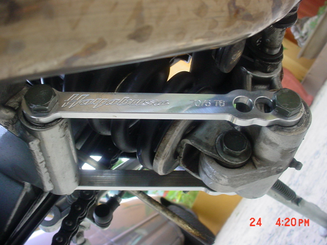

I'm trying a hayabusa dogbones for my skorpion, fits very good and gives 3 height options...

Postby Garf » Wed Feb 21, 2007 10:03 am
Let us know how you get on fella. Do you know whether these would fit the mastif / Baggy suspension as well ? Post a few pics when you are done if you can.

Postby sapperk9 » Thu Feb 22, 2007 9:01 am
Any chance of a pic of the Busa dog bones?

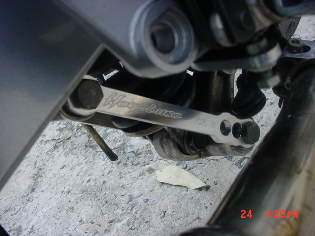

Postby Chayanne » Sat Feb 24, 2007 3:21 pm
Please see photos attached... dog boe part# hayabuza 7075 T6 ...
Dog bone for Skorpion Tour 660cc
(Hayabusa 7075-T6) MOTORCYCLE
(Hayabusa 7075-T6)
(Hayabusa 7075-T6)

Postby sapperk9 » Sun Feb 25, 2007 9:02 am
Nice!! Thanks for the trouble Cob.
I'll have to get a pair.
