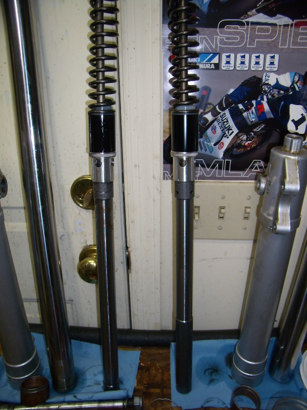

Postby kman.45 » Wed Jan 17, 2007 8:06 pm
Some others have probably wondered like me why compression in one leg and rebound in another. Well the circuits are definitely different! Left side is on right, right on left...sorry. Notice the bottom is very different, and the top of the cartridge on the left side has large return holes in it that the right side does not. Found it interesting anyway.
