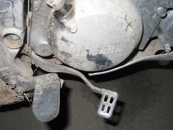

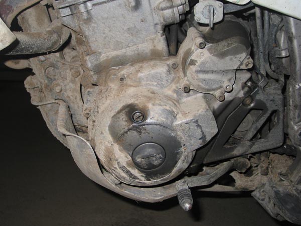

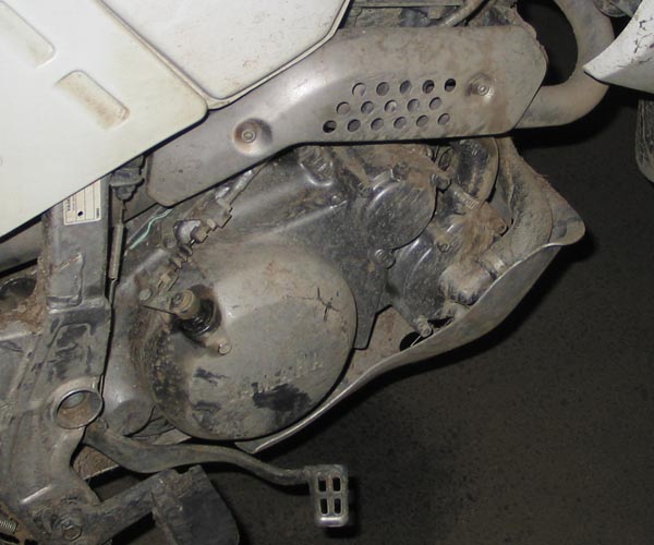

The XTZ sumpgard will not fit strait on because the frames are different. It will probably be a little to short to (even Touratech is to short).
Compare the pictures below to the pictures in my previous links.

Postby keithcross » Fri Jan 05, 2007 2:42 pm
I see what you mean, but it would be better then nowt. It does however look like teh XTZ doesnt have any frame under the engine, is this right?

Postby Hoke » Fri Jan 05, 2007 3:23 pm
No, i don't think there where any.
The Sump guard was mounted to the frame in front of the engine, and in the back where the footpegs are.
That sumpguard was actually very good -i tested it alot :lol:

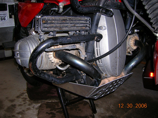

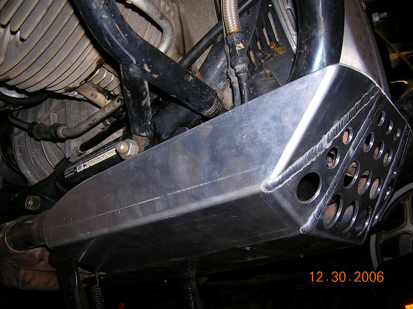

i think the simplest way is to make one - need someone to weld aluminium. like this R100GS one [attached pictures]. friend just made one for TT-R230. flat plates - no bending, just welding.
or get a plastic one - Hyde Developments - and modify it - you can bend them, mold them with heat.

Home Made!

Postby Hoke » Wed Jan 10, 2007 5:01 pm
Thank you! :!: :!:
Great, you just gave me an really good idea! :D
That is the way a skidplate should look like 8)
