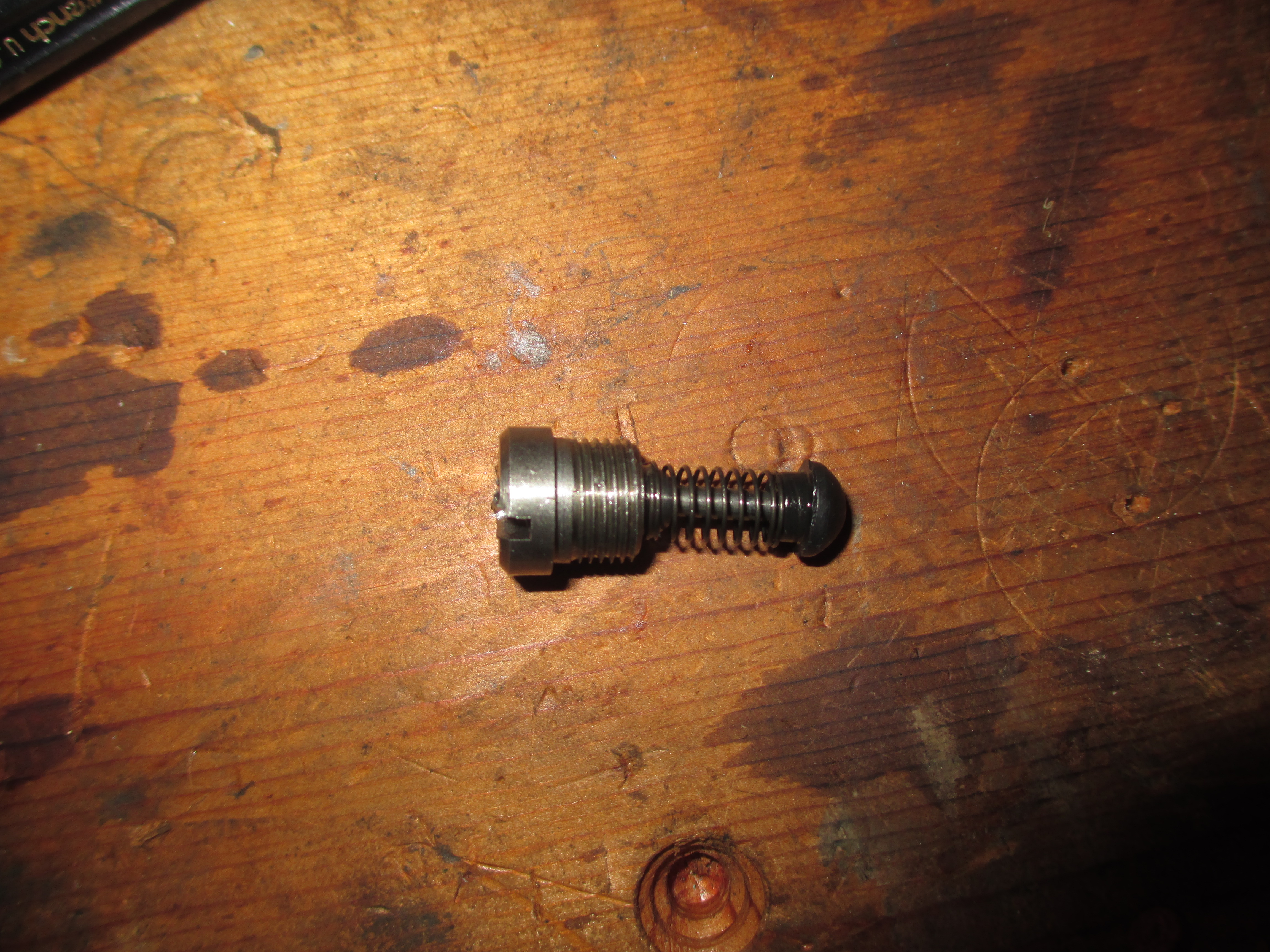

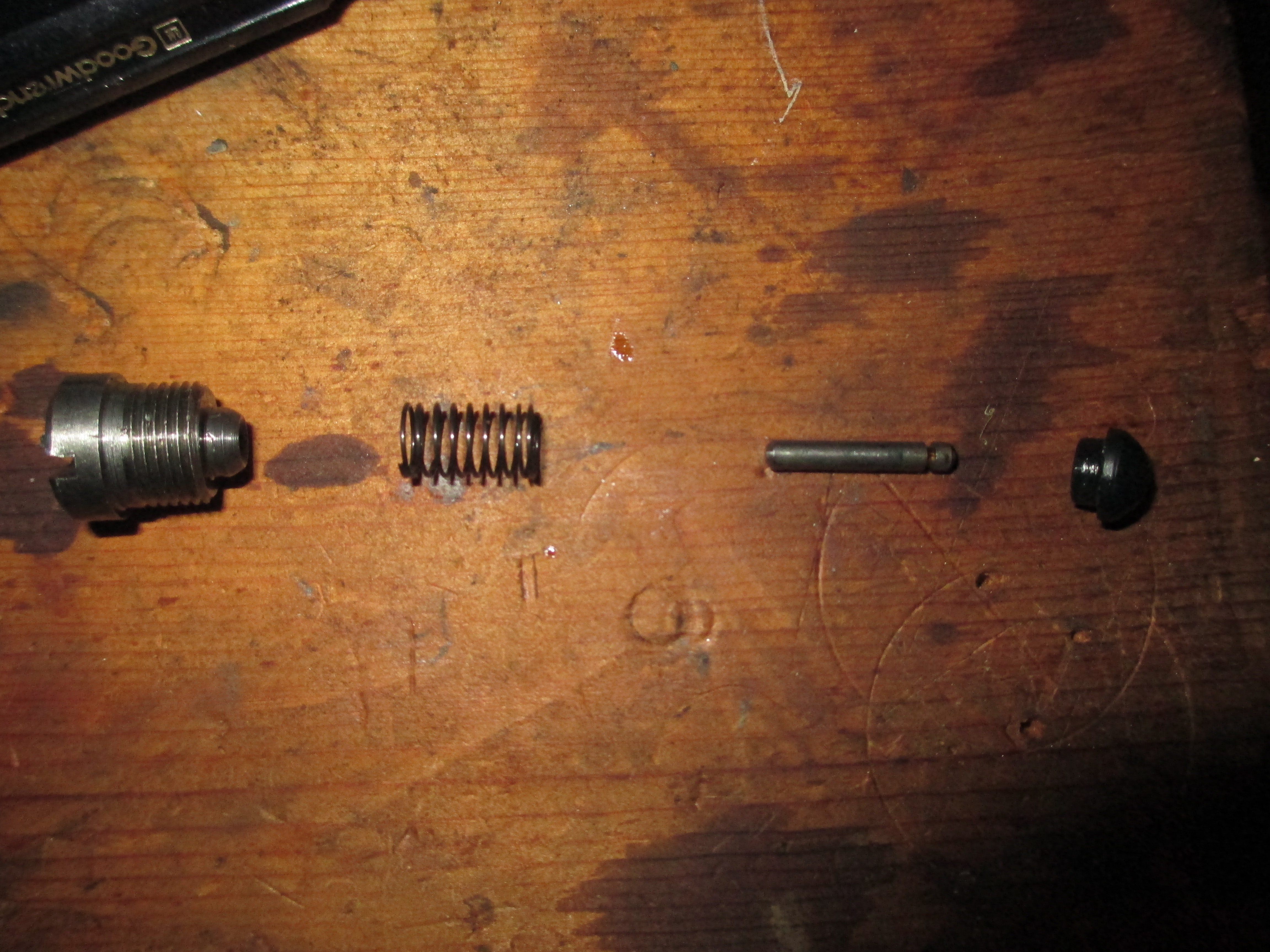

Postby ekirtz » Sun Dec 18, 2016 11:09 pm
If anyone was wondering what the pressure retaining valve actually looks like - here you go. I replaced one today on one of the silver stars I have. You can see it when you remove the oil filter. I had oil draining down from the frame/tank when the bike would sit for a while - evidenced by oil pooled in the breather hose that goes to the air filter housing.
It's no fun to replace, I needed an impact driver (not the pneumatic or electric kind) to loosen it (and I don't think it functions anymore regardless of its condition previously). I wouldn't replace it unless necessary. There is a procedure for bleeding the air out involving removing this valve and kicking the engine through until oil comes out of where the valve was, but my interpretation of the manuals I have seen is that the bleeding is only necessary if one disconnects the oil lines - not every time you change oil/filter. I did this procedure once (different bike)- I was able to remove the valve without damage using the same impact driver, but I think I got lucky that it still worked.
You can see there are four parts. I have pictured the orientation they were in. Note the pin has a detent on one end, the end that goes into the rubber bit.
I will report back as to whether this solves the problem of the oil draining down from the tank. I am optimistic that it will.
If you are planning on removing the valve I think it would be a good idea to have your replacement parts in hand. Certainly it is possible to remove it without any damage and put it back in and have it work perfectly - but might as well be prepared if things don't go well.
Have fun all!
Eli

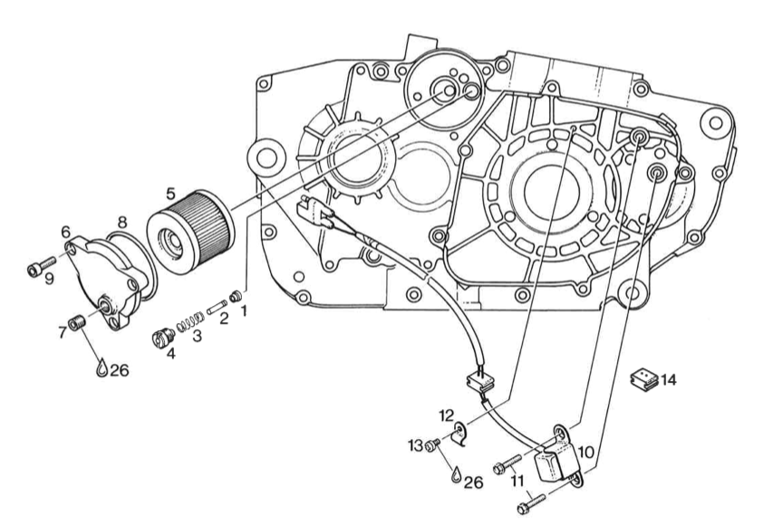

Postby DAVID THOMPSON » Tue Dec 20, 2016 8:41 pm
close up pic of where it is on the bike would help
us who have not worked on the rotax too much
Re: pressure retaining valve assembly
Postby MZCountryRider » Wed Dec 21, 2016 9:49 am
It's in behind the oil filter element, I believe.
Charlie

Postby ekirtz » Wed Dec 21, 2016 10:15 am
Yes - I thought of that picture idea as well...after I had reassembled it! As usual, I'm pretty bad with documenting things while they are happening...

Postby ekirtz » Wed Dec 21, 2016 10:37 am
Well, it's not an action shot..but on the plus side, the camera remains relatively non-oil covered..parts 1-4.. That parts blow-up is the right side of the engine, under the plastic front sprocket cover. In fact now that I look at it - on "our" bikes, at least my MZ's, #7 is actually the oil pressure switch, with a tab terminal that a wire is attached to..
