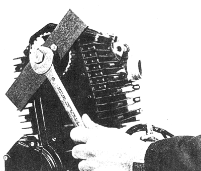

Sorry to hear if you are not well. I am sure the machine will be put back together one day. You are right, the top pulley had a thing of coming off, but they was 2 kinds og pulleys fitted the the engine type, a zinc alloy which ended on the number 22, and then the pure alloy ending at the number 23, min is so stuck. I don think I need any special tool. I will put on the images of the manual, but I can get my head around how they do it irl.
