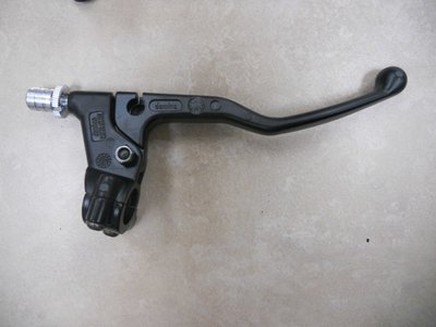

Check out Steve Goode motorcycles, he has a small stock of MZ items, including Domino clutch levers. You can email him at stevejgoode@aol.com. , or check out his ebay store Steve-Goode-Motorcycles
domino lever.jpg (8.14 KiB) Viewed 7262 times
This is the lever Steve has on ebay uk at the moment.

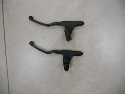

The day after I ordered the lever from MZ Parts Miami I received an email from Disney Ferras asking me to clarify the order. When I told him the lever was for a Silver Star he suggested the one shown in these pictures which he emailed to me.
I explained that the lever appears to be correct, but that the perch, which I don't need, is different because of the decompressor. Disney agreed to sell me the lever without the perch for $25 including shipping. While this is more than the price on the website, it seems reasonable to me, and will get the bike back on the road again in a few days. I appreciate Disney's concern in getting me the correct part rather than simply sending the part I ordered, which might not have worked.
