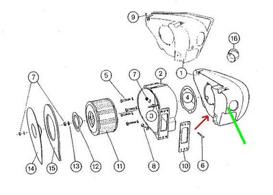

I should have explained this better. Actually it's more like oil than fuel, feels kinda slippery. In the pic below, this fluid is collects at the bottom of the silencer where the red arrow is pointing. Then it seeps out through the sheet metal seam on the bottom and drips down on the toolbox just behind the plastic cover. You really can't see it until you pull the plastic cover off, and it's wet on top just behind the cover lip. I have no idea how this fluid gets there. Both the bike I ride and my parts Silvy has this fluid at the bottom of the air box silencer assembly. Just curious if any of you guys with Silvys have this problem. :(
I'm thinking of drilling a hole in the bottom, installing a nylon nipple, and attaching a drain hose. Sure would like to know how this stuff is getting there though. I'd think it would have something to do with the carb intake hose? But why oily? Image.....

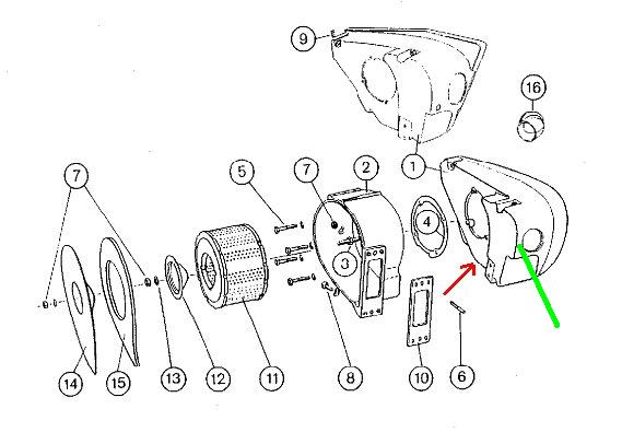

Postby DAVID THOMPSON » Sat Apr 03, 2010 2:23 pm
there is an oil line that comes up from motor
it is hidden by the intake rubber to the carb it goes into air box at the end of the
green line in the picture its hard to see with bike together
see picture
might change the line the one on mine is old and brittle
its where the oil is coming from if you run it at high speed a lot

Thanks Dave, yep, that's got to be it. :-D That hose comes from the crankcase and it's the crankcase breather tube. I pulled it off at the crankcase end and out came about two tablespoons of a milky white oil froth. The carb intake is sucking this crap into the airbox or it's getting blown into it. It's blowby of some sort, which is usually caused by a bad PCV valve in an auto, or bad valve stem seals causing excess pressure in the crankcase. But I'm sure that's not the case here. I don't drive particularly fast either. I bet it has something to do the the breather tube on top of the frame oil reservoir under the gas tank? I think that's how the crankcase breathes. So what's the fix?
