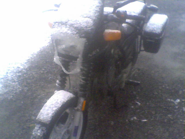

Postby 95SaxonTour » Wed Mar 30, 2011 9:05 pm
Excellent tutorial, hmmmnz! I did mine up like you suggested going with .08 on the exhaust and .05 on the intake. I had to take it for a test ride and of course it was snowing like hell. I now have a little more pep off the line.
Ryan
