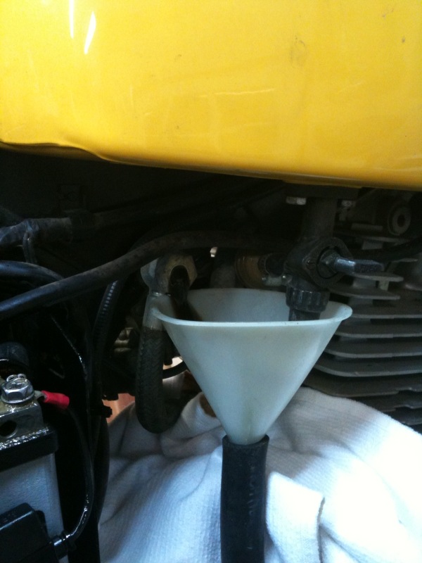

I agree the oil change is a pain but my bike has a plug (allen-head) in the middle of the banjo-bolt attaching the oil line to the lower part of the frame-tank so if you rig up a funnel and hose like this it's not too difficult to drain the tank, still have to remove the skid plate to get at the crankcase drains and remove the plastic cover to get at the oil filter...
My next project is to adjust the valves...
