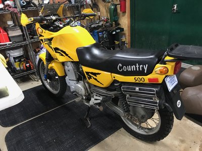

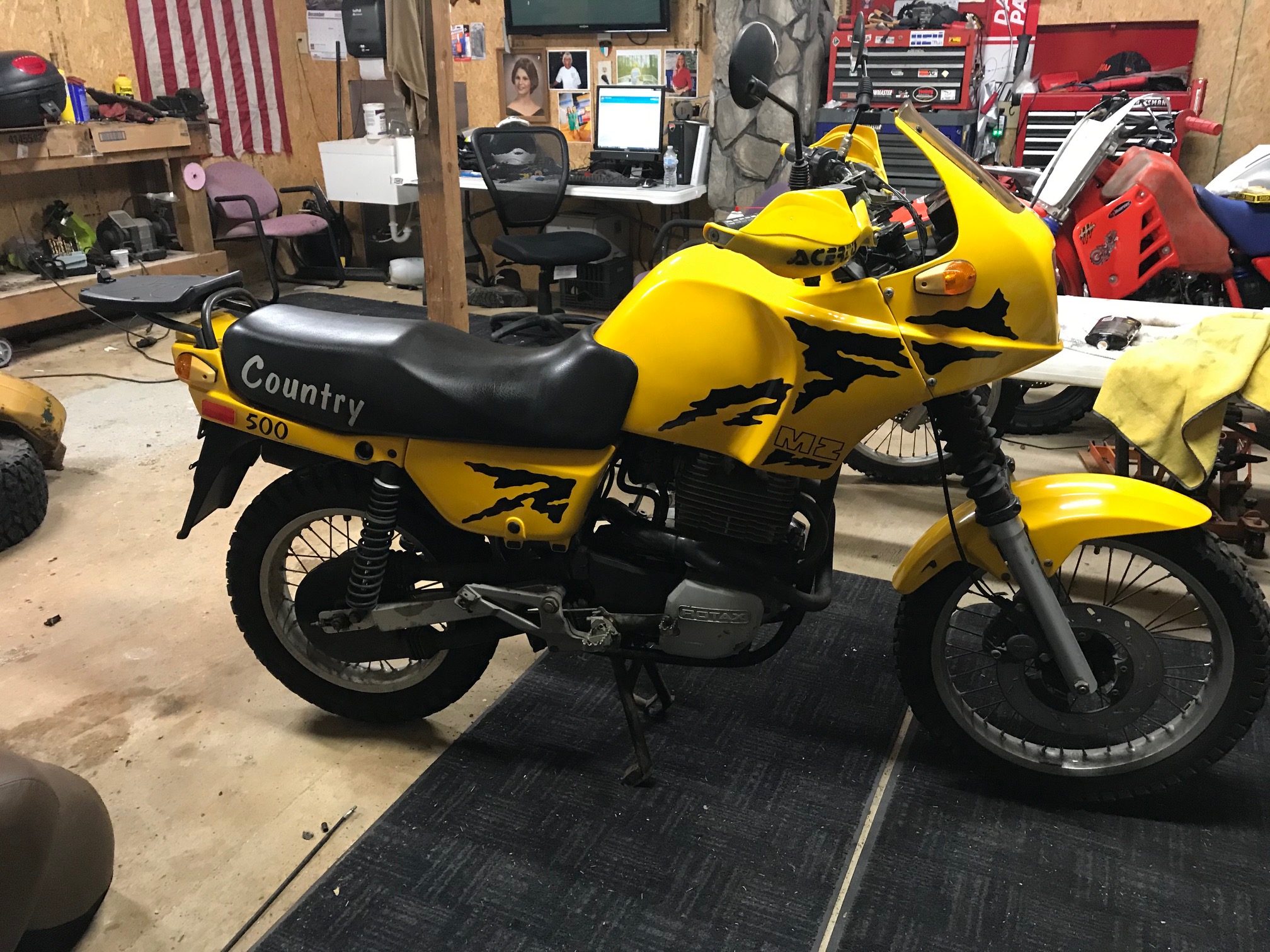

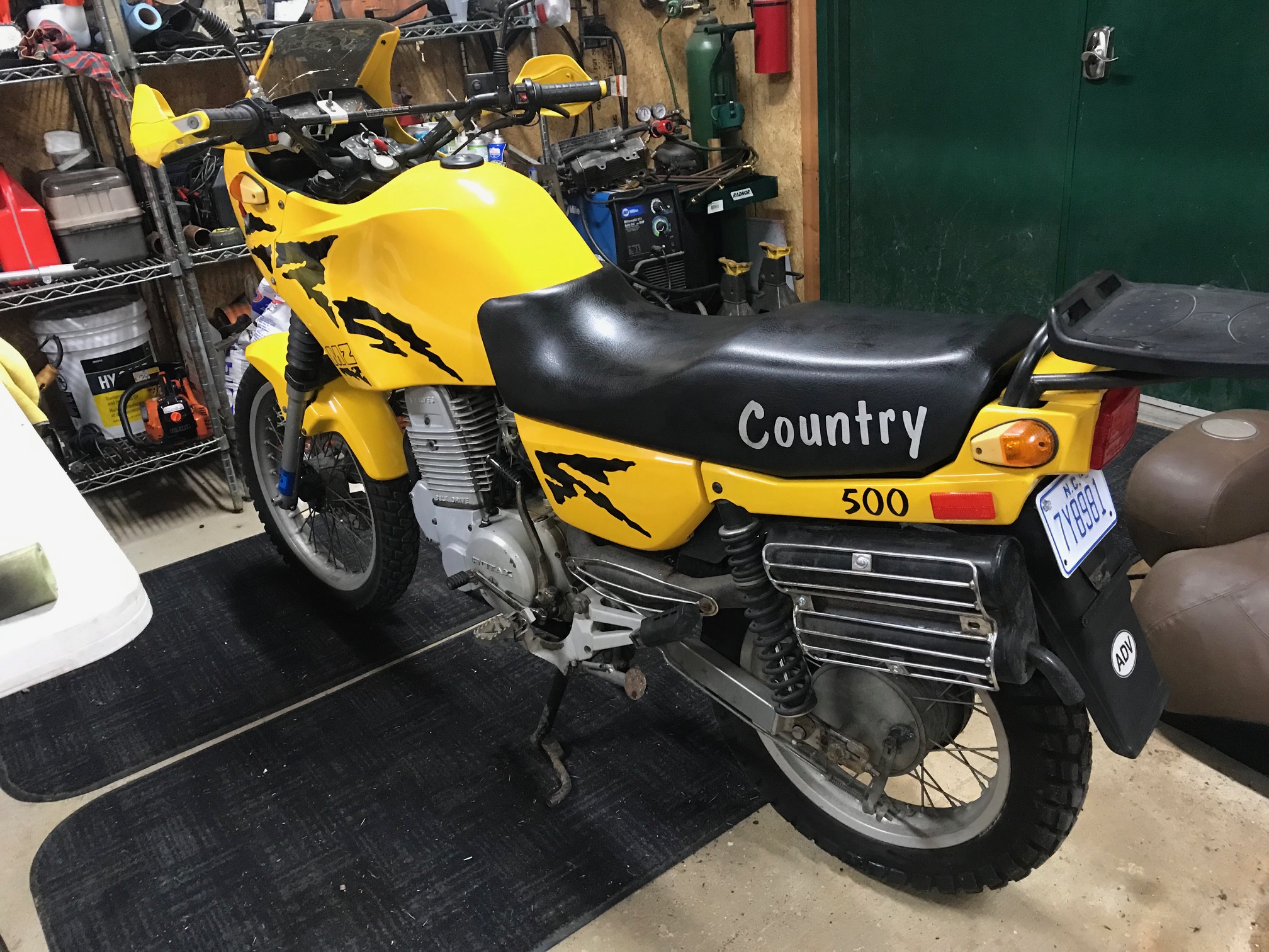

Today I got the pain in the ass oil change done yesterday and finally got to ride the bike today. It doesn't have a bunch of pep but accelerates like an electric motor. Just seems to wind out. After sitting for at least 5 years and hasn't been tagged since 2006, it runs pretty good. It start and idles just fine , I put in a new battery, changed the oil , air filter , lubed the cables, greased the chain which looked new as well as the front sprocket, checked the ground wires,loose, and filled it up with non ethanol gas. This bike rides as well as or better than my BMW gs. the low cog make u turns a breeze. I guess I need to change the tires , they look new but are at least 10 years old. I was thinking about these tires , https://www.chapmoto.com/bridgestone-ba ... 330-011458 , hoping they won't rub the chain protector. Here are a few pics of the bike. Later this winter , I plan to install new tires and clean up the hubs and rims and remove the exhaust and paint it too.
