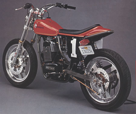

give me the 600 ace with cvt and a wood racing flat track frame
and i will build a weapon that will scare people
atkusa 605 esds mid 1990's comes to mind but a bit on the tall side for short people
and if you find a good used one you need a DEEP pocket book

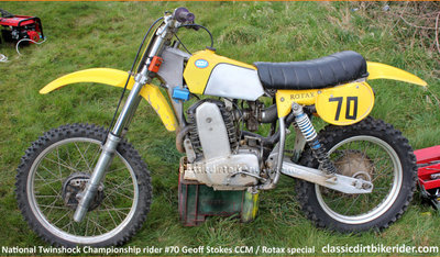

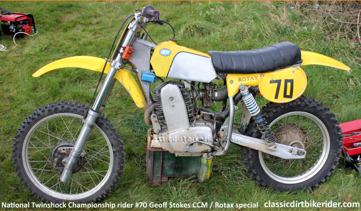

Postby Puffs » Wed Dec 30, 2020 6:49 am
I don't know the details of their CVT, but it is likely to cost power. I don't mind shifting.
That's a nice looking flat track bike. It isn't, but it reminds me of the CCMs from a while back; didn't they also use that Rotax engine?

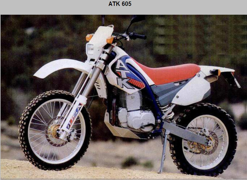

The ATK David mentioned:
Gorgeous bike IMO. Details from https://www.motorcyclespecs.co.za/model ... 5%2096.htm
