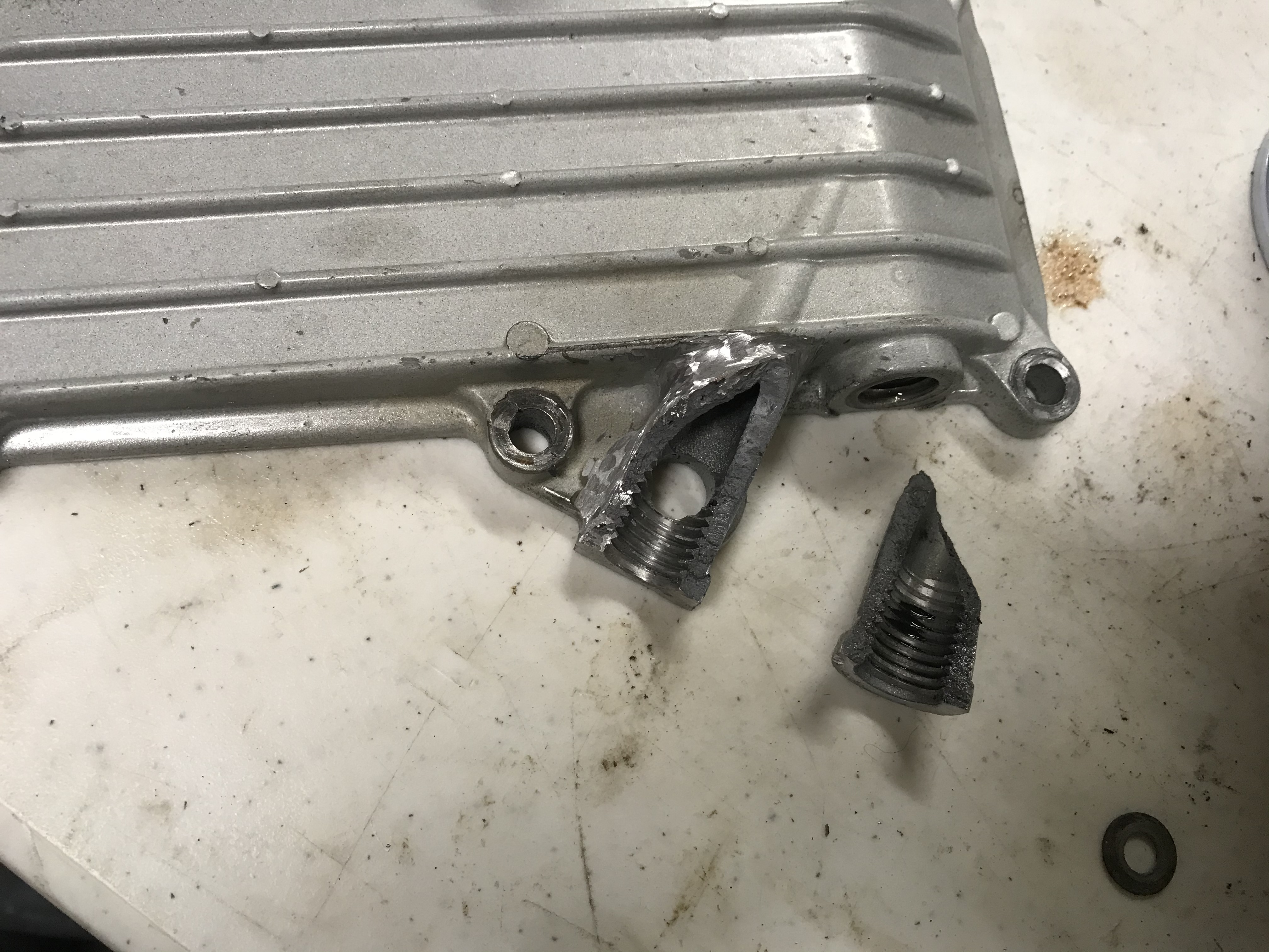

I had a slight set back over the weekend. The cover on the oil pump had some JB Weld on it and after the oil change I noticed oil seeping out at the drain plug. When I tried to snug it up tighter, it broke off. I think that’s why the bike was sold to the guy I bought it from. He said he had no idea of its condition when I bought it. I think I found a new cover from ATKUSA. I’m still waiting on confirmation he has one. If not, I will try a machine / welding shop to weld r up.

Postby breakwellmz » Tue Dec 22, 2020 2:59 am
Oh bugger!!
I have a feeling that may be magnesium so you may have a problem getting it welded.
If it were mine i think i would re-glue it back on with a suitable epoxy and reinforce/buildup the area with JB weld putty, but then that`s me!
Good luck with it.

Postby breakwellmz » Tue Dec 22, 2020 5:38 am
That might be the case with a taper thread but not a parallel one, and you can see the damage mark leading up to the fracture.This is effectively a sump plate on the bottom of the engine and i suspect the damage was done by a rock.
A solid threaded insert would be a good repair but personally i would bond it in place at the same time as the broken off piece.
I bet a new one is bloody expensive!

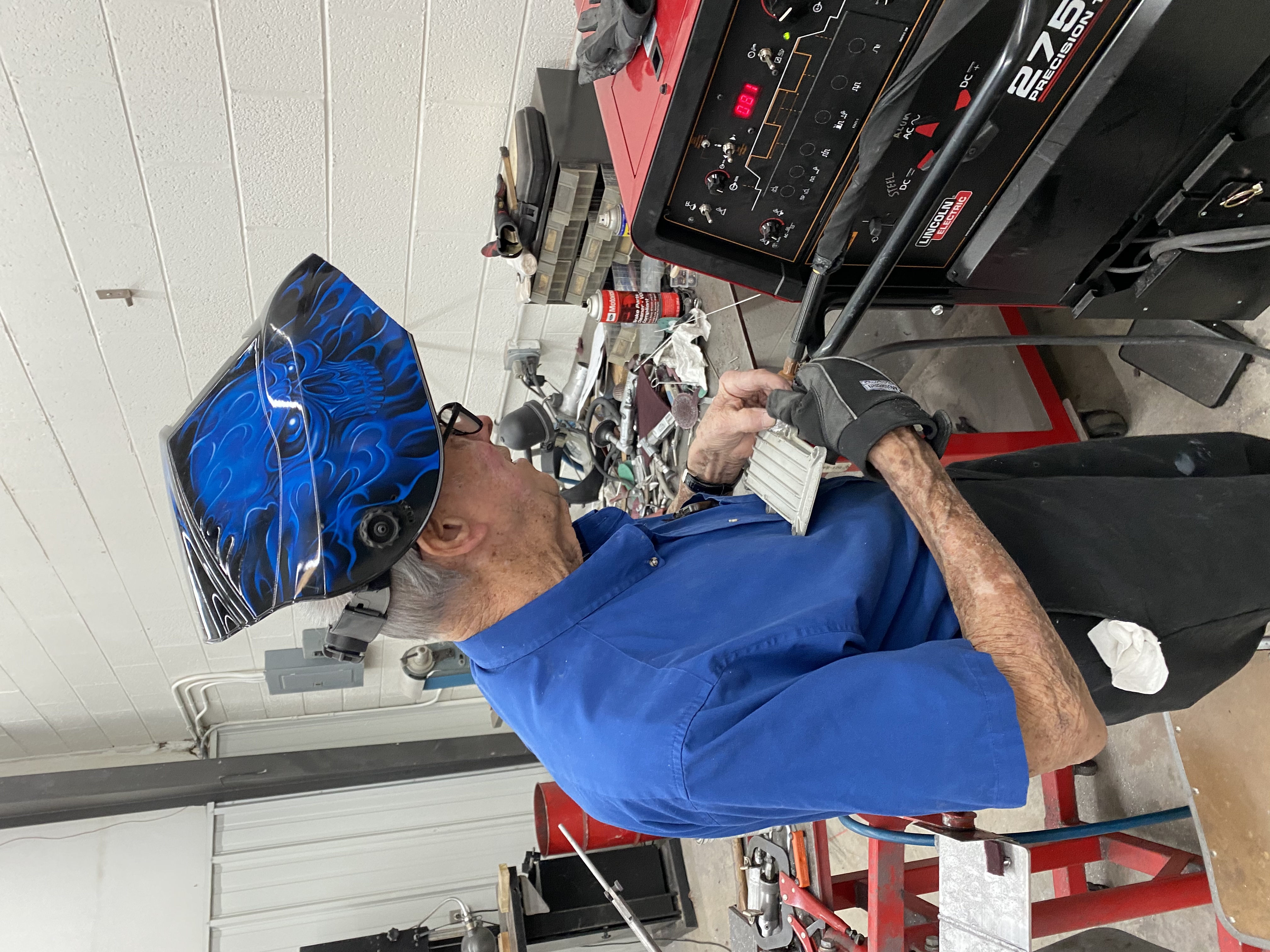

Update on my oil pump cover. My best friend owns Wood Brothers Racing. The number 21 NASCAR , oldest race team. Anyway he took my broke cover to his uncle Leonard Wood. He welded it up in no time and cleaned up the threads. Here is a pic of Leonard in action.

Postby breakwellmz » Thu Dec 24, 2020 4:34 am
Good old uncle Leonard! Aluminium?

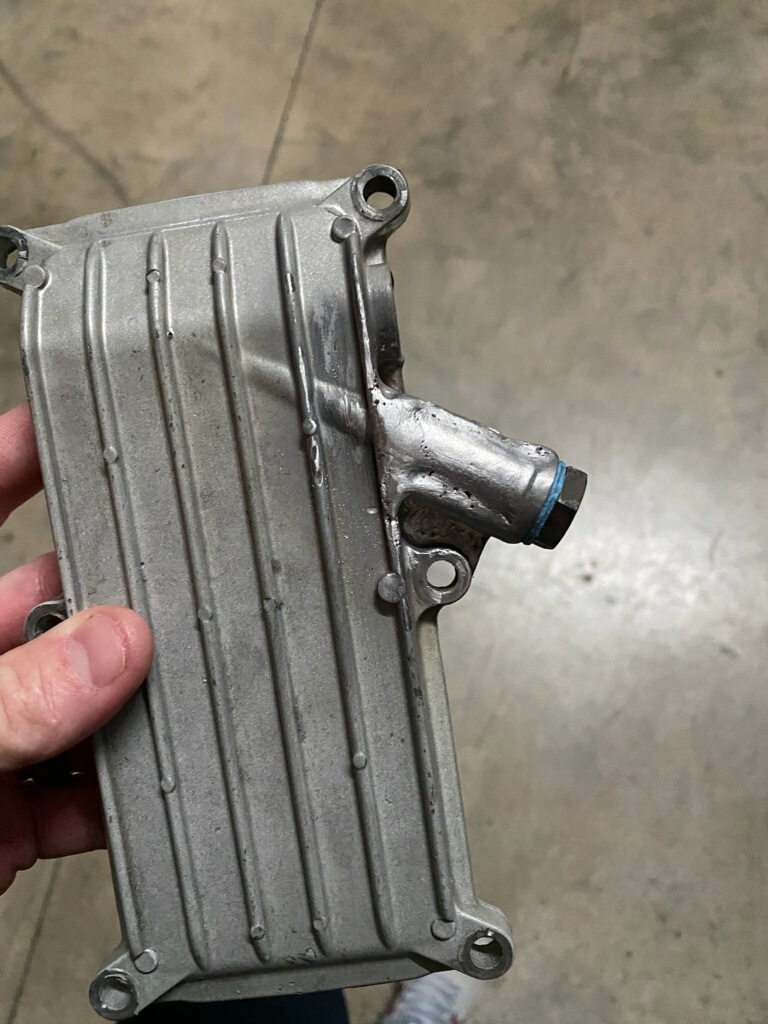

Postby Little General » Thu Dec 24, 2020 11:37 am
Finished product. Leonard said it was cheap aluminum and bubbled a lot but somehow he tested it with brake fluid. It seems brake fluid will find its way through a tiny crack sooner than any liquid.

Postby Puffs » Fri Dec 25, 2020 5:21 am
Great job!
Don't over tighten the plug; consider some (silicone) sealant if it still leaks at the plug.
