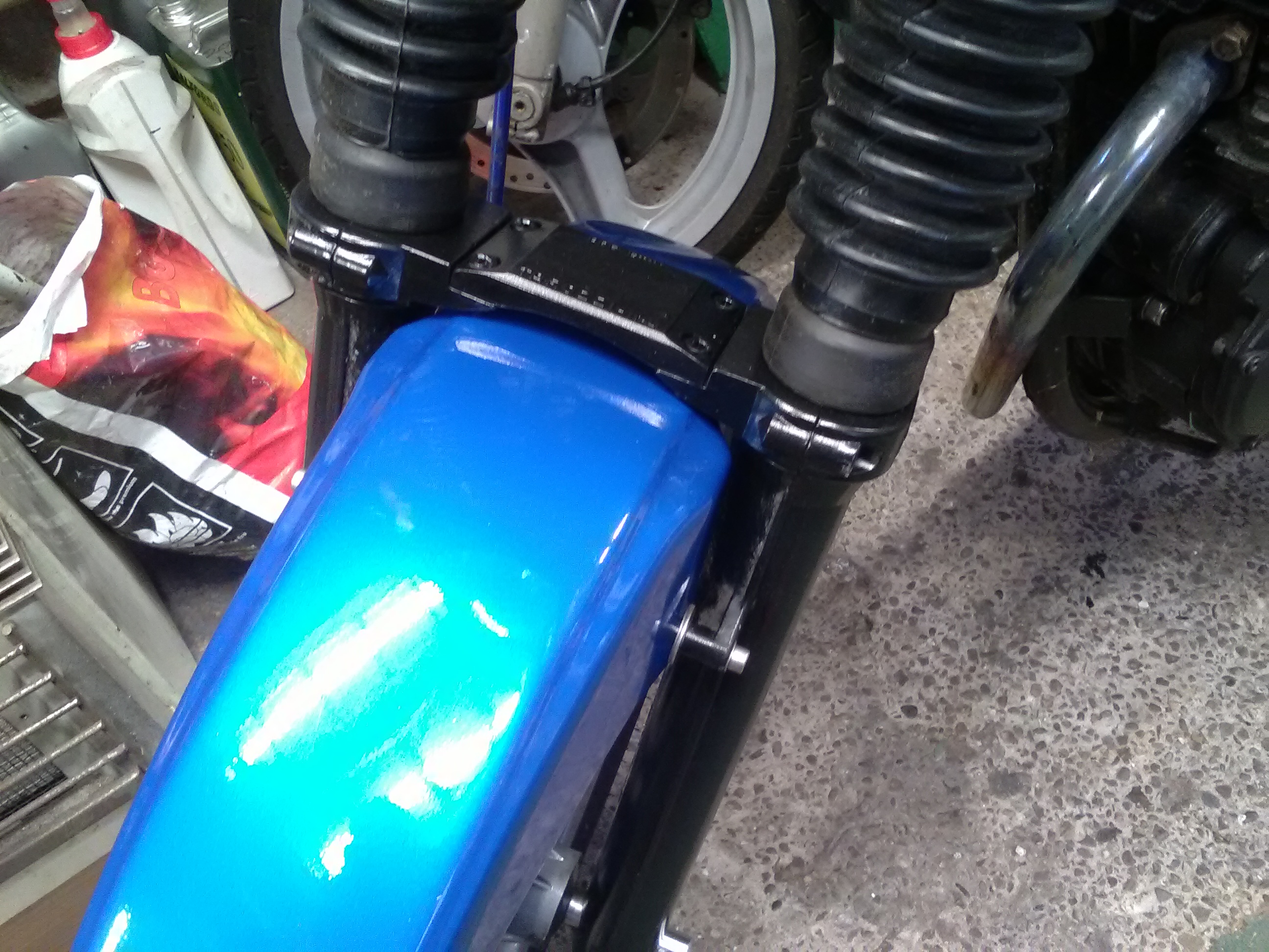

For anybody with an interest, I went ahead and fitted Tarozzi fork brace to my 500R and feel it has stiffened up the front end particularly under braking. Recommended.

Ta Ralf, can you share a pic?

Postby ralf » Wed Dec 09, 2020 10:11 am
Sorry for the late response, photo of the brace here.

Postby Puffs » Thu Dec 10, 2020 5:10 am
That looks very decent! Thanks.
