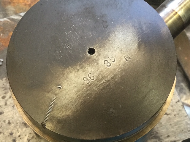

I think your right about keeping the carb a standard BVF. This bike has been quite a challenge. I bought it from an old Aussie Hell’s Angel who had given it to his son to ‘play with’. One of the more interesting fabrications the youngster had engaged in was to manufacture a pannier rack. The rack was attached to the upper AND the lower rear suspension. This made the handling somewhat ‘Sporty’
Back to the seized barrel/piston. I think I have come up with a diagnosis. The Amal was running really rich as the correct 210 main jet had been drilled out to about 250. This was done to compensate for a incorrectly fitting head gasket. When I tried to lean it off. It was fine until a constant high rev run.

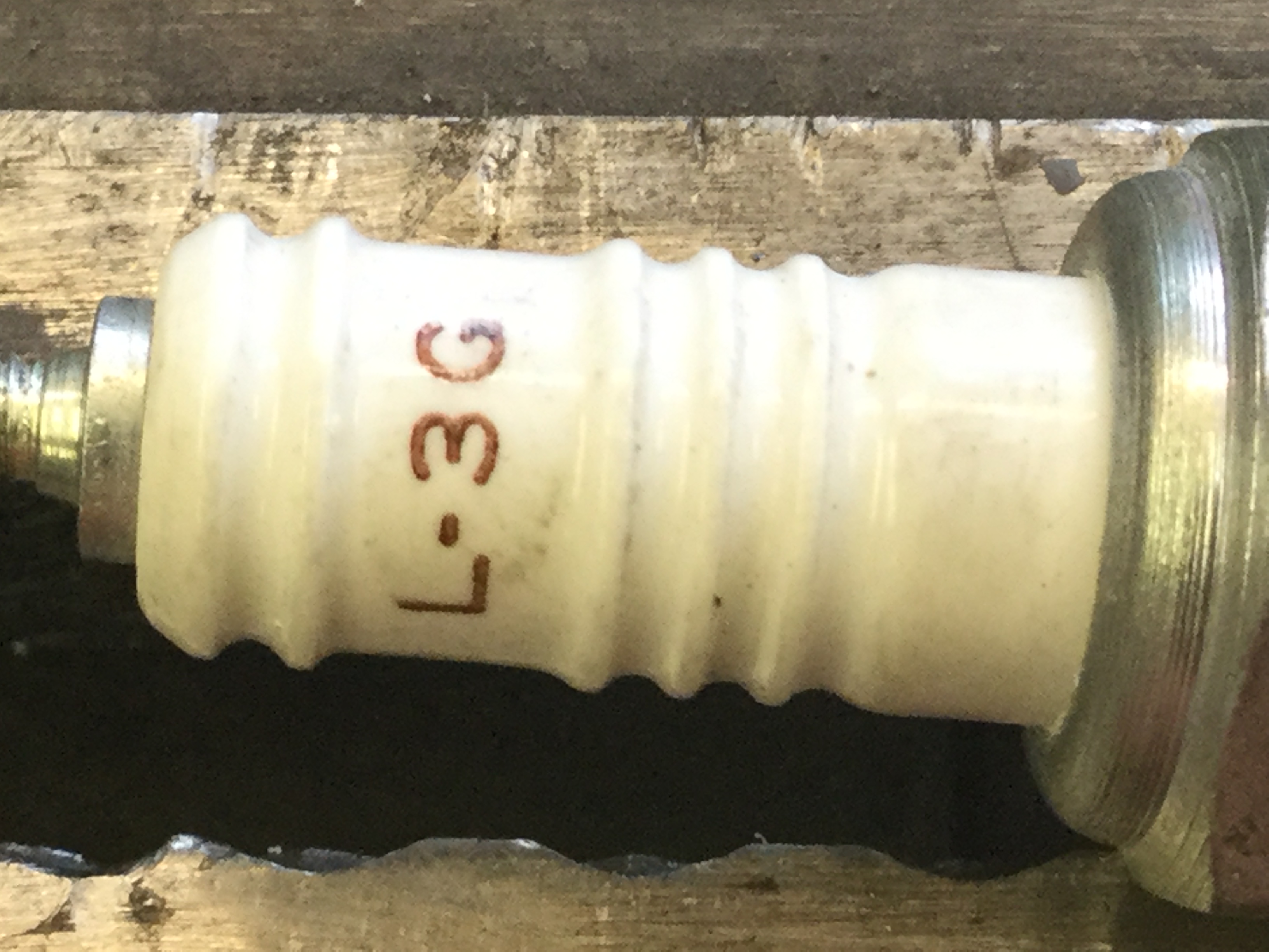

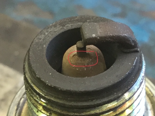

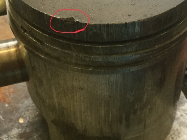

I’v enclosed some pics of the damage and would been interested in anyone’s second opinion. The spark plug was new old stock Champion. Opinion on the flakey insulator will be very welcome.
Many thanks Dave

Comments on your pics:
- I do not recognise the piston from what I see, but the size (68.96) suggests it's a piston fitted in the original bore, with 0.04mm recommended clearance. Looks like something (a small bolt????) left a mark on the crest, do you see similar in the head?

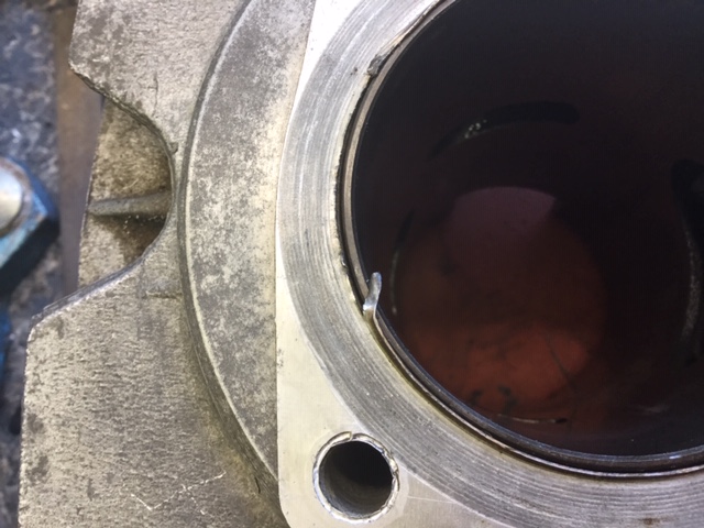

Your 2nd piston pic shows it was properly seized. There's no pic of the barrel, but you probably need a re-bore. Buy a good piston.
- The Champion L-3G should be equivalent to the NGK B8HS, so that should be fine. Bit on the cool side maybe. The colour of the insulator might suggest it was run a bit lean (consistent with your diagnosis), but it's not all that clear to me.
- You might want to use a new head gasket, and when installing it first properly fit it around the ridge on the barrel. However, it looks like the head properly carried onto the gasket, so I don't really see a problem in it leaking, and I see no signs of that either.
When re-assembling w/ a new piston & gaskets, also have a look at the clearance between piston (in TDC) & head, the squish band.

Re: Hello and my 1st post after my 250/1 sezied.
Postby DAVIDGUEST123 » Mon Jul 08, 2019 12:46 pm
Thanks for the info Puffs.
The oil I've been using is the Fushs Silkoline Super 2 At 40:1ration. The mark on the crown have got me puzzled ( no marks on the head). Needle bearings ok

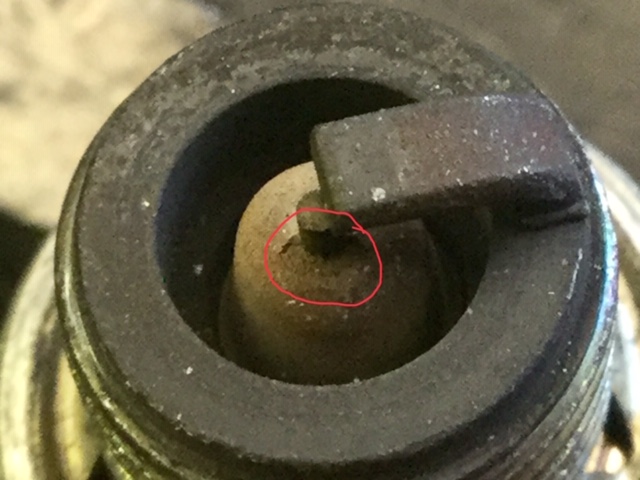

and I've not found anything stuck in the head...maybe a bit of piston? Also to me the colour of the spark plug looks ok, half brown along the lower conductor.

Postby Puffs » Tue Jul 09, 2019 4:04 am
That oil should be excellent & 1:40 should also work fine. Look in the book though, MZ may also for this bike prescribe 1:50.
That mark on the crown looks like something a small bolt could have left, but then there should also be a similar imprint in the head - or it happened in another head. That's also possible, that this piston was previously used in another engine, and possibly incurred some damage there.
Only other suggestion is trying to measure the clearance between piston & barrel (feeler gauge, measure at skirt), but that's probably not going to work well/ be reliable because of the damage.
Seriously lean should be closer to whitish in colour, but normally a 2T looks a bit darker than that; it does appear to be a bit on the lean side IMO.

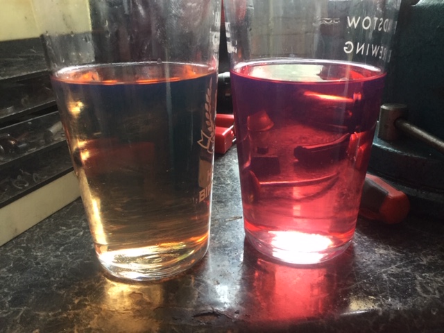

The mystery is solved. Rebore, piston gaskets and a couple of hours in the garage working on the bike , might help jog my memory when filling with petrol that oil needs to be added.
Pint on left from bike. Pint on right premixed on the bench. Bloke behind the camera ...muppet.

That's the advantage of using coloured 2T oil, as apparently that Fuchs Silkolene is. With lighter honey-coloured oils, the only way to find out if you added oil is to put some on a clean dish & let the petrol evaporate (outside, in the sunshine). If the dish feels greasy after that, you have, if not, you haven't.
