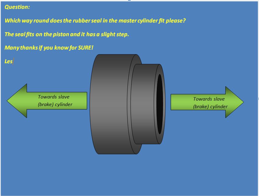

just a simple question as regards the seal in the master cylinder
Thanks in anticipation:

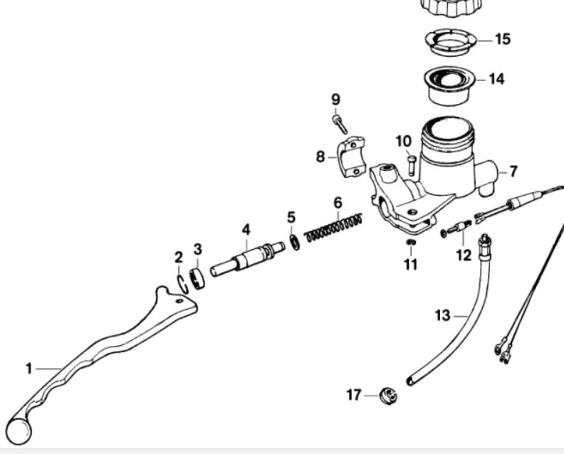

It's a 1988 MZ ETZ 250...The master cylinder has the round white plastic reservoir with black plastic cap....
Part number 30-24.080...Item 5
Thinking about the way it works a little more I reckon its likely the smaller diameter part faces the pressure... IE: the brake cylinder.
100% confirmation would put my mind at rest though.

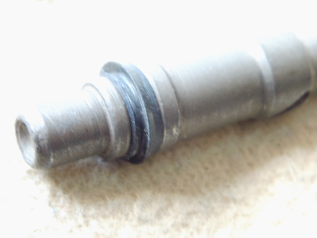

Postby Guesi » Sun Apr 07, 2019 3:36 am
This is how it should fit....

In reply to Blurredman. I may have confused you with my description "OIL Seal"...perhaps I should have used the MZ description "O ring" but I didn't as it's NOT an O Ring!...A better description would be "Piston Pressure-Seal" or similar. There is an oil seal at the lever end however. (Item 3 in the parts diagram above)
In reply to Guesi...Yes that's the part and many thanks for actually showing the picture of it in situ on the piston. It seems obvious now looking at your picture and indeed after checking the new item again much more closely. It is clear there is a taper on the circumference which gets pushed outwards by the pressure to further seal against any oil being passed by it. I did not notice this originally.

Postby nice2day » Sun Apr 07, 2019 11:48 am
Well I fitted the piston seal but now I'm not sure about the outer lever end seal :(
If you look at the photo, the seal appears to have the knife edge part upper most so it should fit towards the oil (inwards) BUT the taper on the outer rubber diameter looks as if it won't press in unless you fit it the other way round as the taper seems to favour pressing in with the flat plain side first...Sorry to ask again but can anyone give me an assured answer please?

Postby Guesi » Sun Apr 07, 2019 1:02 pm
The top side of the rubber comes in direction to the inner side of the brake.
The flat part (bottom in the picture)comes outside towards the lever.
But this rubber won´t last very long.
I prefer double lipped oil seals (which have to be brake fluid resistant)...
