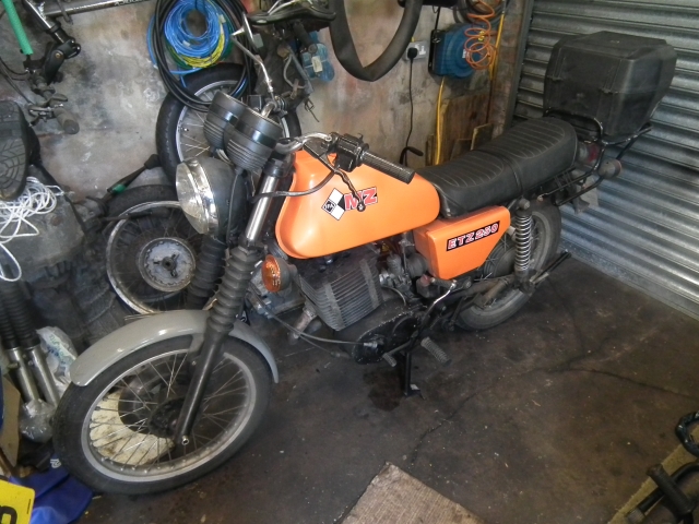

Quick write up, for I have now re-built two ETZ 250 engines in just a month, and disasembled another that looked like it had been under the sea for a number of years for potential re-build in the future.
After re-building my '87 ETZ 250 with a replacement crank, which turned out not to be the problem, but let's not go there-

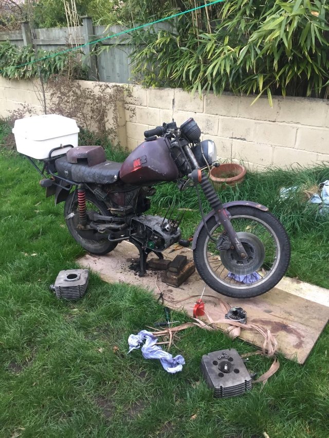

My trusty old '90 ETZ 251 was long suffering from a slipping clutch, and had now at the mileage of 42,000 had a tendency to jump out of third gear, and become a little difficult to put in any gear, for that matter.
After entrusting my newly rebuilt steed for my commuting matters, I decided to strip the 251 engine and re-build that too. The bike has sentimental value after I purchased it in 2016 for £100 with a completely seized top end. I had put a worn original size piston/barrel on, and over the next few months diagnosed a coil fault, and implementing electronic ignition as the contact breakers would not set up correctly. I then covered 13,000 miles on it since then without any real major issue other than replacing a few things here and there.

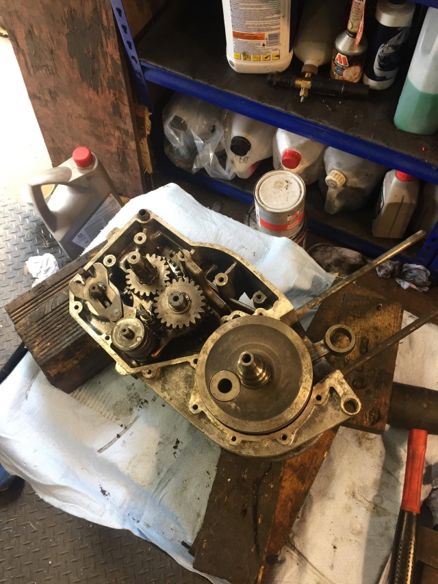

And so.. on the bench, I take the clutch cover off and find the first problem- the gear selector disc thing (i'm not really sure what they are called) was not on the selector barrel. it was off. The reason for this? The retaining spring had come off the pin! Not sure how that happened, but it was replaced on reconstruction.

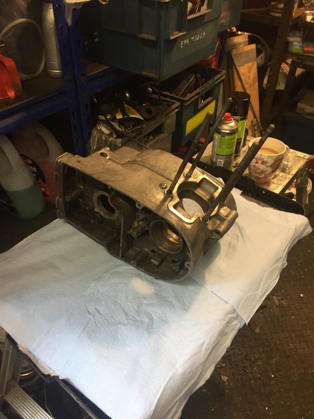

After splitting the cases, I find 40k miles and 30 years of gunk, metal debree and yuckiness at the bottom of the gearbox.. Clearly it has been well abused before my ownership- indeed when I hammered out the seized piston from the barrel in 2016- It was on 2nd oversized already!
It took a long time to get the gunk out, constant washing down with carb/brake cleaner.

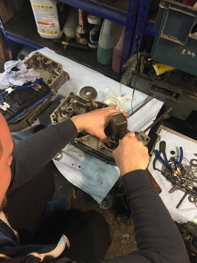

But, with it clean and all the bearings removed, it was finally time to re-instate the new bearings- Don't worry- I am hammering on the old bearing, with something soft in between to catch debre. :lol: There is defiantely something satisfying about punching in, or out, bearings!

And thus, the gearbox was cleaned, and put together, and implemented in the LHS crank case with the crank. I found nothing wrong with the gears, nor with the selector forks or drum to indicate the 3rd gear issue was with the 'traditionally' found poor machining, thankfully a quick fix hopefully.
Everything went smoothly upon the crankcase construction, including the all new seals etc too. And thus, it was time to install it on the bike:
