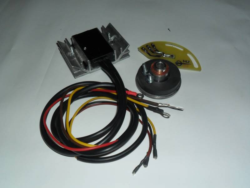

All the units I can find, original or otherwise have a box associated with the 'kit' that contains the electronics. Whether this is the large plastic box containing mid-80's tech resistors, transistors and diodes etc, or a later type.
Lots of you I am sure are using the PowerDynamo systems sold by MZ-B. But they are an expensive bit of kit, as they include stator and rotor and a few other items, that I do see the positive side of (for example- it is a self exciting bike with this system installed).
2 years ago I purchased this aftermarket system, which does have electronic box I have mentioned a little bit before. It does however have the benefit over the original factory system of a much more substantial cooling system, as well as 10/15 second coil signal shut off and an LED, helping you identify your timing much more precisely. I have used this for 10,000 miles now and I have not had any problems with it. It is reliable, consistent and maintenance free which is what everybody wants in timing :-D

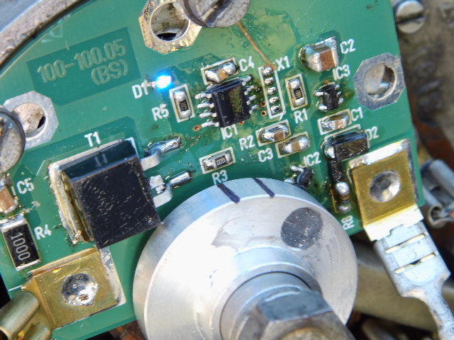

Recently my friend in Hungary showed me this item, which I have also seen on one or two youtube videos in various guises:
It has a major component that is not including the LED timing light on the board (where you would want it if anywhere). But it has all the electronic components found inside those large boxes, on the timing plate itself! There is but one wire in the kit, as well as the sendor rotor. Fiddly wiringharnesses!? Seems that has gone. You re-locate the coil wire that comes from condensor on the contact breaker set, to one of the terminals on the timing plate, and the included wire connects the other terminal to the other contact on the coil.
The lack of components in this new system means that it is actually quite cheap too! The electronic ignition I already have with the large aluminium cooling fin system on the box and the 6 wires to connect up was £65. This new system from Muller Electronics was £40, delivered from Hungary.
Now... Do not get me wrong - I am currently reserving judgement, as I am going to install this new contactless ignition soon. This post is a write up on my experiences with this new electronic ignition and a review. The only downfall I can see in the small print (at the moment) is that max voltage this item can withstand is 16v DC. Which to me is a very close tolerance to potentially being blown and unusable if your charging system is not on par! As all other electronic ignitions other than PowerDynamo, this item is only a direct replacement to the points and does not at all interfere with the charging system bar 20mA draw.

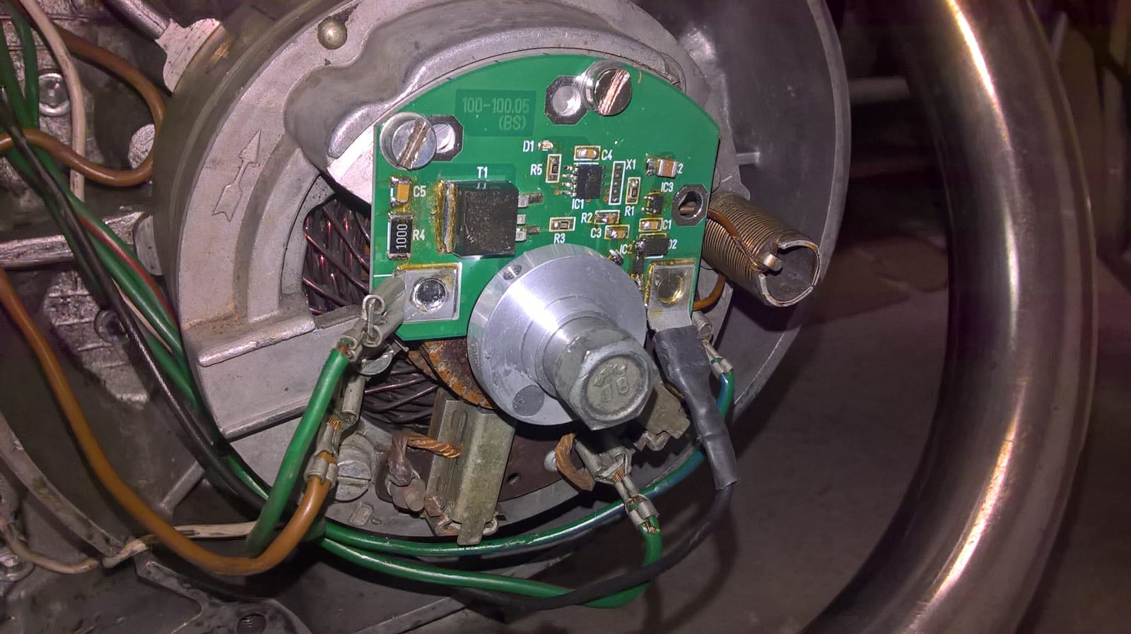

Postby Blurredman » Fri Nov 16, 2018 4:21 am
I knew there must be other people working on such items, I had seen it.
Well, the unit is on my machine (albeit with timing problems but that is another matter).
It was obviously extremely easy to put on the bike.
The green wire that comes from terminal 1 on the coil was relocated to the appropriate spade connector on the plate. And the accompanied wire (albeit a few inches too short for some nice and neat out of sight routing), was put on the other spade connection and the 15 terminal on the coil.
Obviously the cam was put on and the plate tightened up. To time, as always I do:
Ignition on, this lights up the timing light LED to a half brightness. As you move the plate back and forth you can find that once the timing point has been reached the spark has occured the light brightens to full luminosity and then extinguishes completely. Find 2.7mm BTDC, adjust plate. Spark occurs, tighten up plate. As easy as any other machine, but with the benefit of the timing light being exactly where you would need to look- Not on a black box that is situated elsewhere on the bike (if your black box has one at all).
As you ride, the timing light will be constantly flashing, It's pretty cool. And if you have a problem with black box than these items, including Guesi's one would be very good. One thing that came to mind when fitting the cam was that on most other electric systems, they remind you of a certain gap requirement between cam and the sensor on the board. Most are around 1-1.5mm or so and come with spacers, if needed. There was no mention of gap requirements with the Hungarian instructions provided.

Postby Blurredman » Sat Nov 17, 2018 11:36 am
I must confirm that this is a Hall Effect type ignition. And, thus far has worked flawlessly.. 8)
Only thing is you have to bend the terminal contacts angle slightly to avoid interfering with the generator cover. But that's no biggy.
