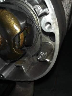

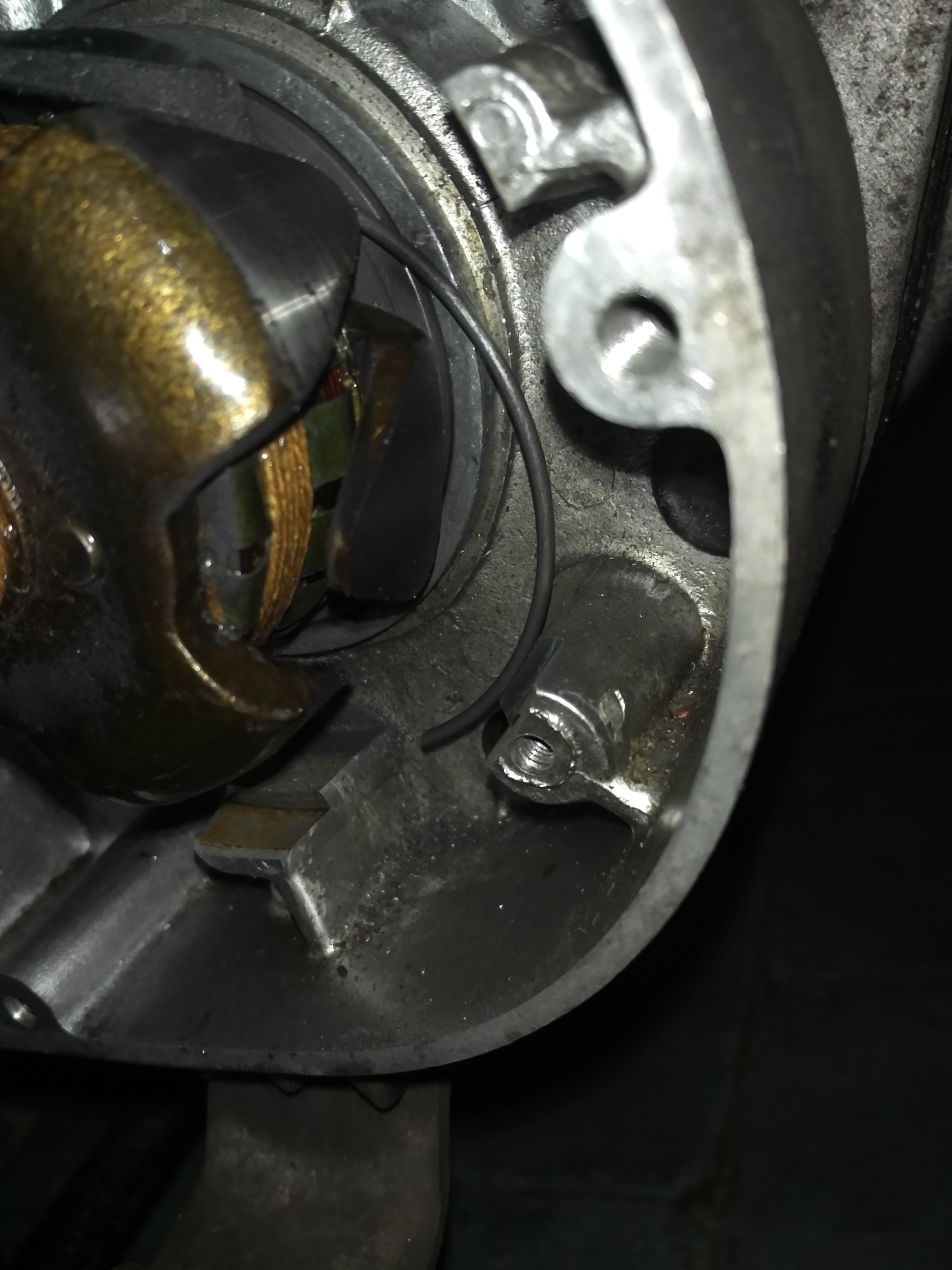

Postby BubbleOz » Thu Jan 11, 2018 6:10 am
A picture is worth a thousand words...
Best cancel the replacement regulator I guess...

Postby Blurredman » Thu Jan 11, 2018 6:22 am
I suppose that is the C Clip that retains the seal? :lol: :lol: :lol:
Posts: 1266
Re: ETZ250 Voltage regulator smell & Alternator sparks
Postby BubbleOz » Thu Jan 11, 2018 7:52 am
Sure is. .packs a mean spark :)
