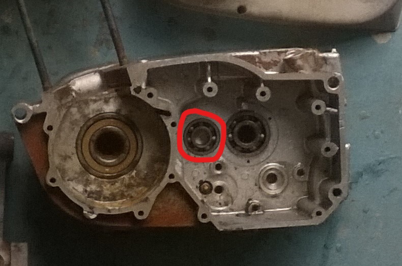

There is only one thing I may have continued problems with and that is removing a single gearbox bearing that cannot be punched out from the opposit side. :lol:

Have you tried heating the case in the oven before attempting to remove the bearing ?

Postby Blurredman » Wed Nov 08, 2017 4:48 am
I haven't tried removing any bearings yet.
But according to the over-haul video on youtube, the bearing requires a puller that expands behind the inside race.
From 12:25 minutes in..... https://www.youtube.com/watch?v=4J70JChZ9e4&t=3439s

Postby ivor » Wed Nov 08, 2017 5:07 am
You could try heating in the oven, then turning the case face down on a plank of wood and banging down sharply, the bearing may then drop out. Or find someone with a lathe to machine a mandrel out of aluminium or steel to just a thou or two under the inside diameter so it's a close sliding fit. Then two thirds fill the hole with thick oil, put the mandrel in the hole, hit with a hammer and the hydraulic pressure should push it straight out. There are videos on Youtube showing it being done I think.

Postby Blurredman » Thu Nov 09, 2017 4:07 am
Well I got all bearings out other than the one I specified.. Even the crank bearings were alright! I will think of some plan to remove it somehow.
Posts: 1266
Re: ETZ 250 Engine Re-build!
Postby ivor » Thu Nov 09, 2017 4:13 am
The hydraulic method is a very good way.

Postby AlanJ » Thu Nov 09, 2017 7:16 pm
Hi Ivor,
Please excuse me asking, but wont the oil under pressure go round the corner and then through the ball race? Or am I not seeing this right? Incidently you can get an internal bearing puller from Ebay for a tenner, but not sure if there is enough room under the inner race for the jaws to hold and at that price it will be from China so, who knows. Just had a look on Ebay and the puller is £14.69

Postby ivor » Fri Nov 10, 2017 3:58 am
I thought we were talking about a bearing in a blind hole, if not then sorry. I'm not familiar with the 250, the TS125 internals are another matter !
A puller meant especially for the job at that price is worth buying.
Or perhaps an expanding bolt meant as a heavy duty fixing in building work could do. If the bolt was a common thread get a longer bolt and slide something like say a socket over the shaft and use it as a slide hammer.

Postby Blurredman » Fri Nov 10, 2017 4:07 am
I believe there is a little space behind the bearing but not much. Just enough to get a bearing puller in. I hope I can borrow one off my neighbour as this is one of the only 'special tools for vehicles' that I haven't bought over the years. The bearing itself is open sided and is a 6203, so internal diameter is 17mm according to specifications on the internet.

Postby Skyeport » Fri Nov 10, 2017 4:01 pm
The space behind the bearing is quite small. I bought a bearing puller from the local tool supplier, but there wasn't enough room for the jaws, I'm sure I'll use the puller somewhere else...maybe.
Be cautious with the hydraulic method, there is only a thin bit of alloy behind the bearing & too much pressure on a stubborn bearing may pop the case behind the bearing, don't ask how I know, although this makes it easy to get at the bearing from the other side..................

Postby AlanJ » Sat Nov 11, 2017 6:56 pm
Hi Guys,
I know I am a thick old bugger, but will somebody explain how the hydraulic system works because I can see it might move the bearing a little, but as soon as the bearing moves then the oil can go under the inner race and then through the ball race so it probably wont work after the bearing has moved a small amount. If the inner race is smaller than the outer, then the oil will go round and probably not move the bearing at all. Guys come on and tell me I am not seeing this right, I don't want to offend anybody, just understand. The reason I am asking this is after I have finished the refurb on my Honda CB400A, I will sort out the Saxon in the boxes so, there is the 301 for that and I have a spare 251 so there I is a good chance I might have this bearing problem, so.

Postby Skyeport » Sun Nov 12, 2017 12:17 am
I am not sure how oil would work either?
I used candle wax not oil, same principal just thicker & doesn't leak through the bearings as easily.
This is the bearing in question?
