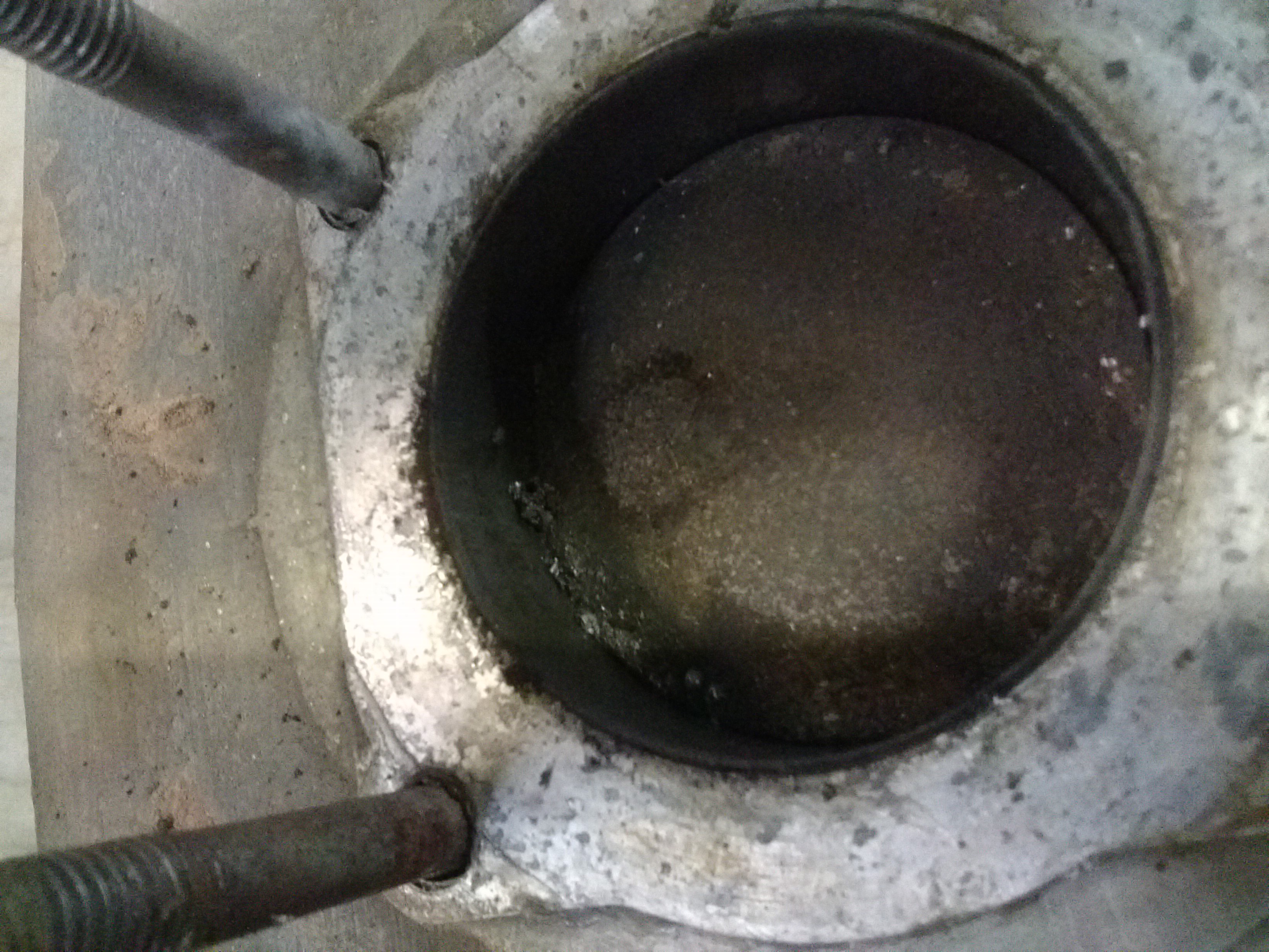

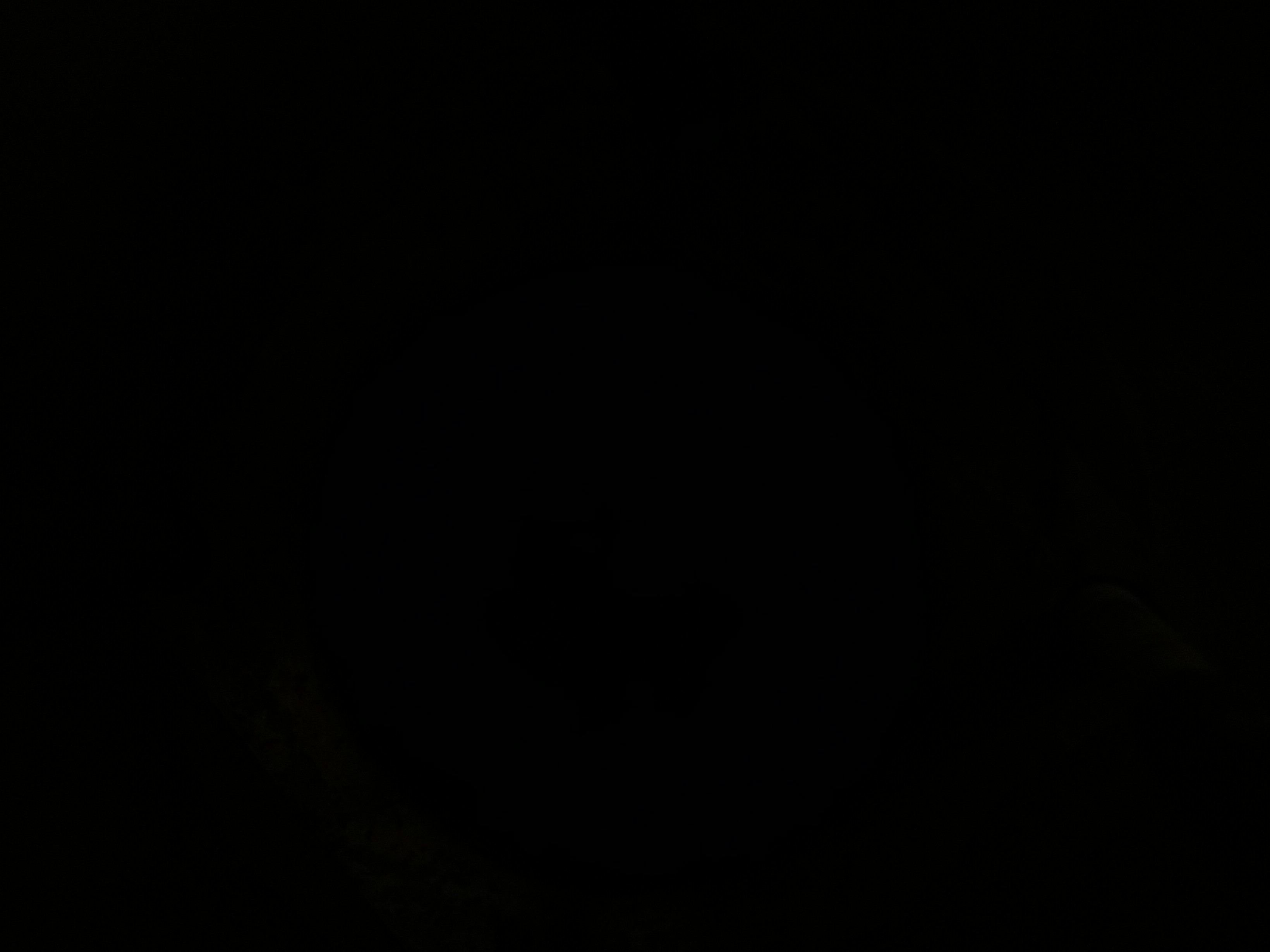

Postby Carlos » Wed Jul 12, 2017 12:12 pm
Thank you for the replies.
These pictures show great encouragement... Please give feedback to the next step.
Obviously cleaning and removing the small particles is a must.

Re: MZ250 motor slowly seized.. Is there any way back from t
Postby DAVID THOMPSON » Wed Jul 12, 2017 12:38 pm
see post above about use of good shop rag and take the barrel off

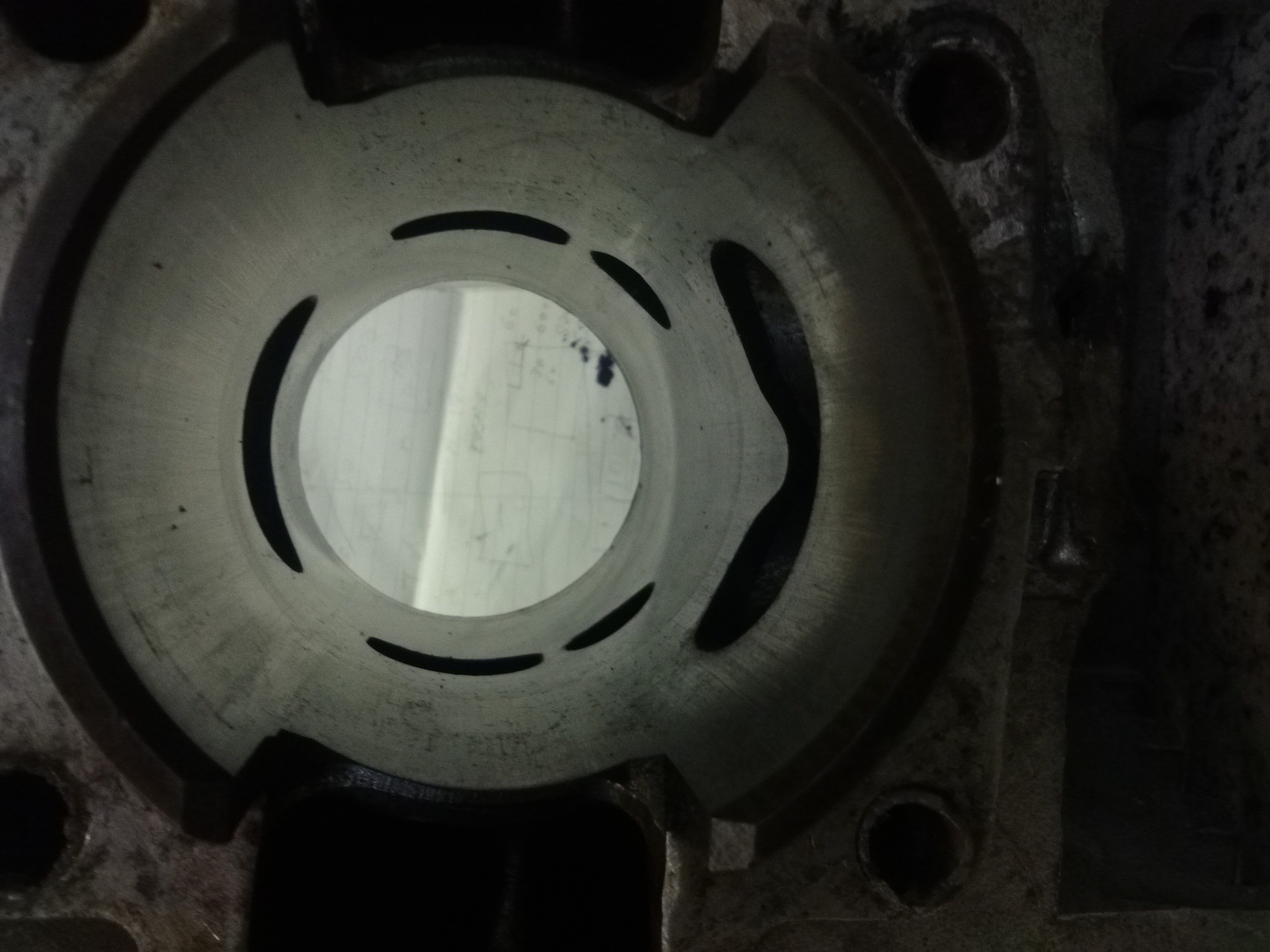

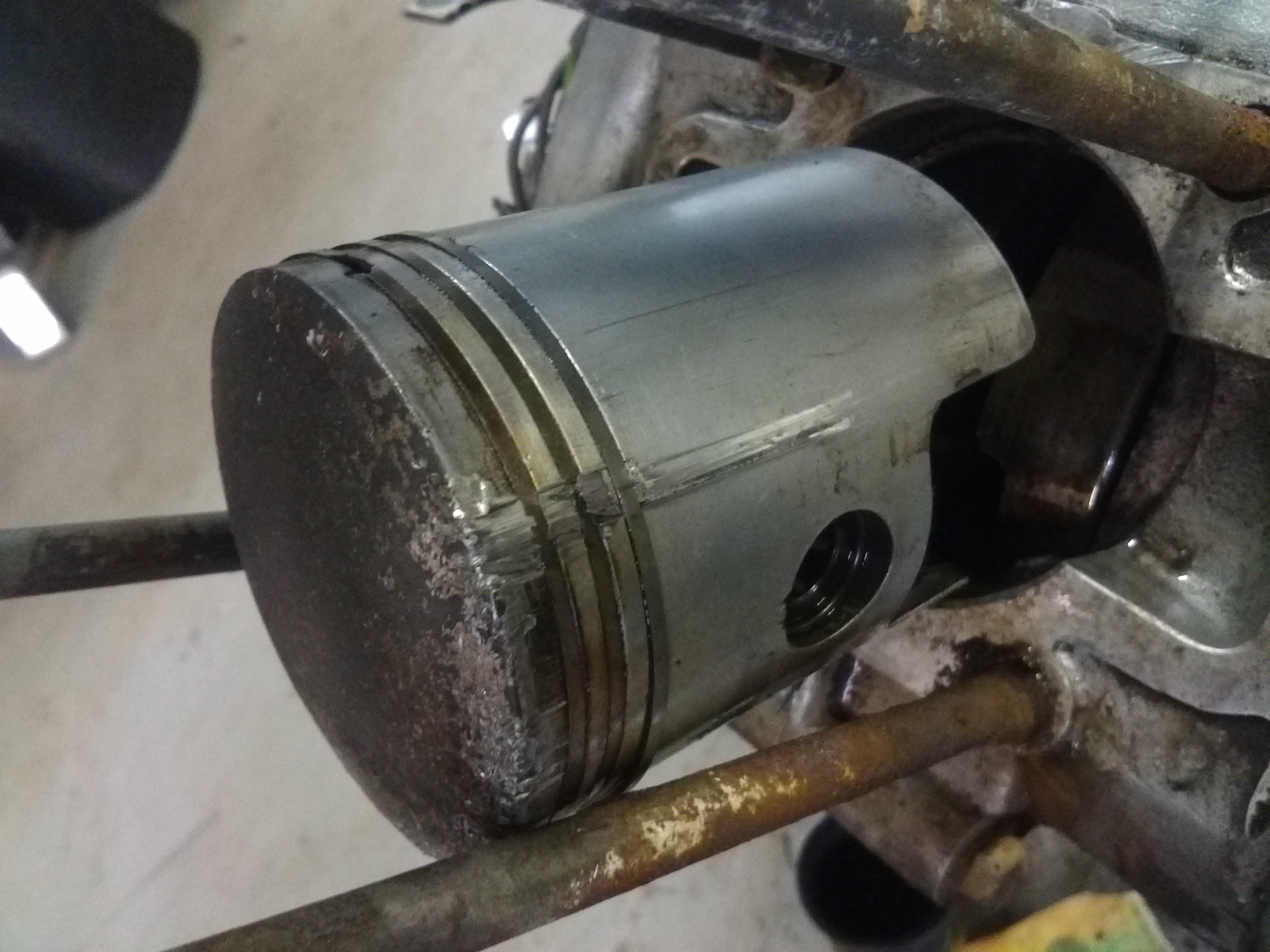

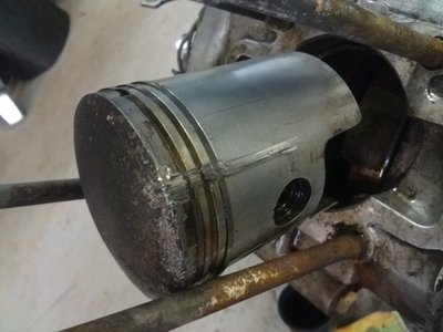

Postby Carlos » Thu Jul 13, 2017 7:07 am
So, as you can see I made some headway.
Even tho the piston is free the rear wheel STILL WON'T TURN IN GEAR. I have noticed that the bracket the piston is attached to its stuck in place. It does not move and this is stopping the full revolution of the engine. It looked pretty dry in there, have not checked the oil yet tho it was topped up a month ago.
How would you proceed? Can I lubricate round the seized bracket? (please someone tell me the correct term for this) could I use WD40 or go with chainsaw oil? I do not have any gearbox oil on hand you see and I don't know if that penetrates.
Ideas please guys we are nearly there i feel.

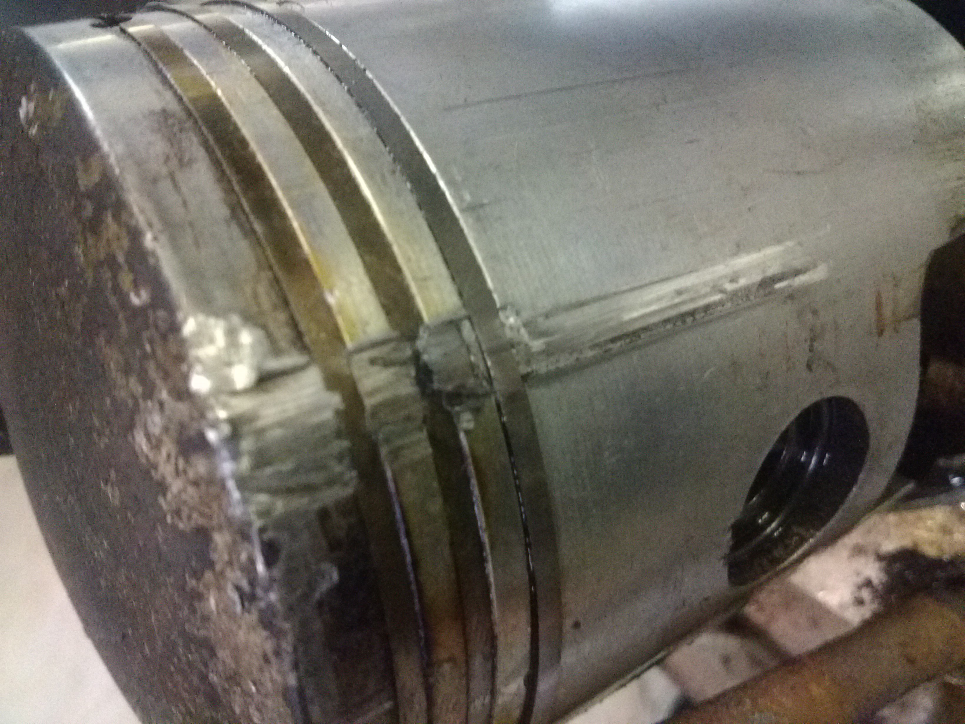

Up closer on the piston rings
Rings still moving everywhere except here, clean up and go? Or new rings

Postby Carlos » Fri Jul 14, 2017 4:40 am
You guys still with me?
When I order new rings where do u take the measurement for ordering? On the piston I assume. And my piston ranges from 71.2mm - 71.5mm do I assume that this is a 71.5mm ring i must order?
Also the connecting rod has slowly started to free up, does anyone know a way to lock the motor so I can gently nudge the rod free and move it round a full revolution eventually?
Thank you
