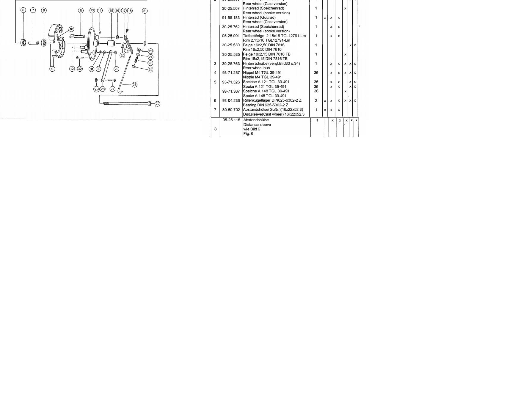

Postby DAVID THOMPSON » Mon Feb 13, 2017 1:06 am
wheel 500r left click on picture to make bigger up in the picture numbers 6 is bearing 7sleve 8 is bearing 9 ?
Re: Sprocket bearings..
Postby 95SaxonTour » Mon Feb 13, 2017 2:07 am

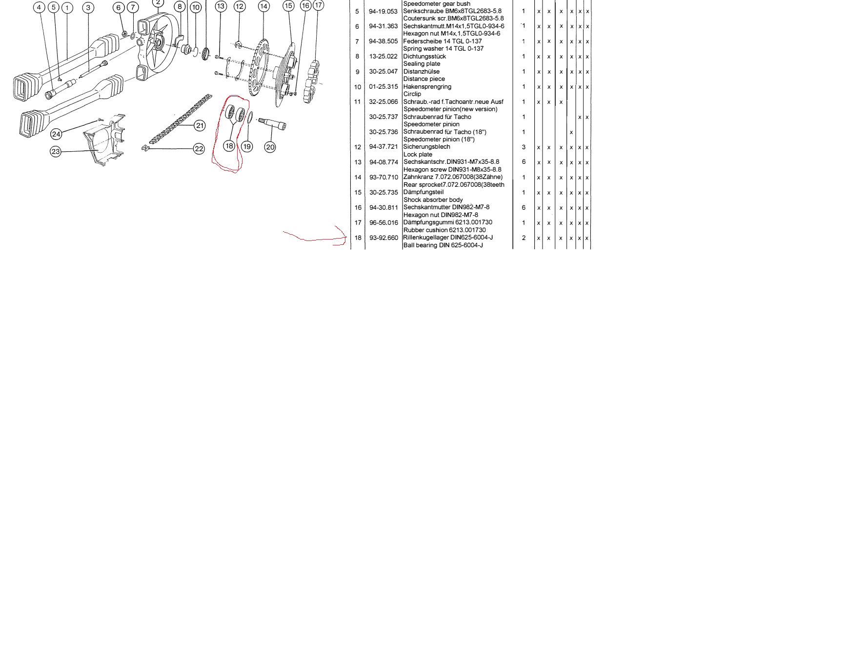

Thanks Dave, but I need the roller bearing numbers for the chain side. The two (I think) that are pressed into the piece that holds the sprocket
95SaxonTour
Posts: 77
Postby DAVID THOMPSON » Mon Feb 13, 2017 1:54 pm
here
Postby 95SaxonTour » Mon Feb 13, 2017 6:16 pm
6004 bearing then..
