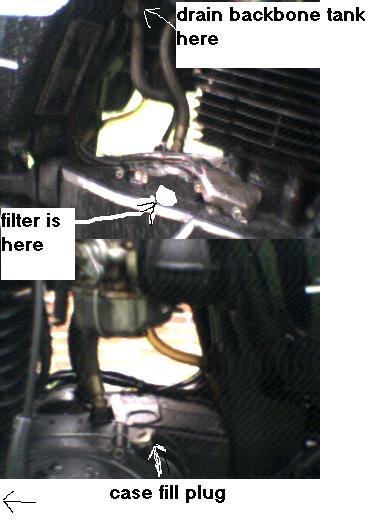

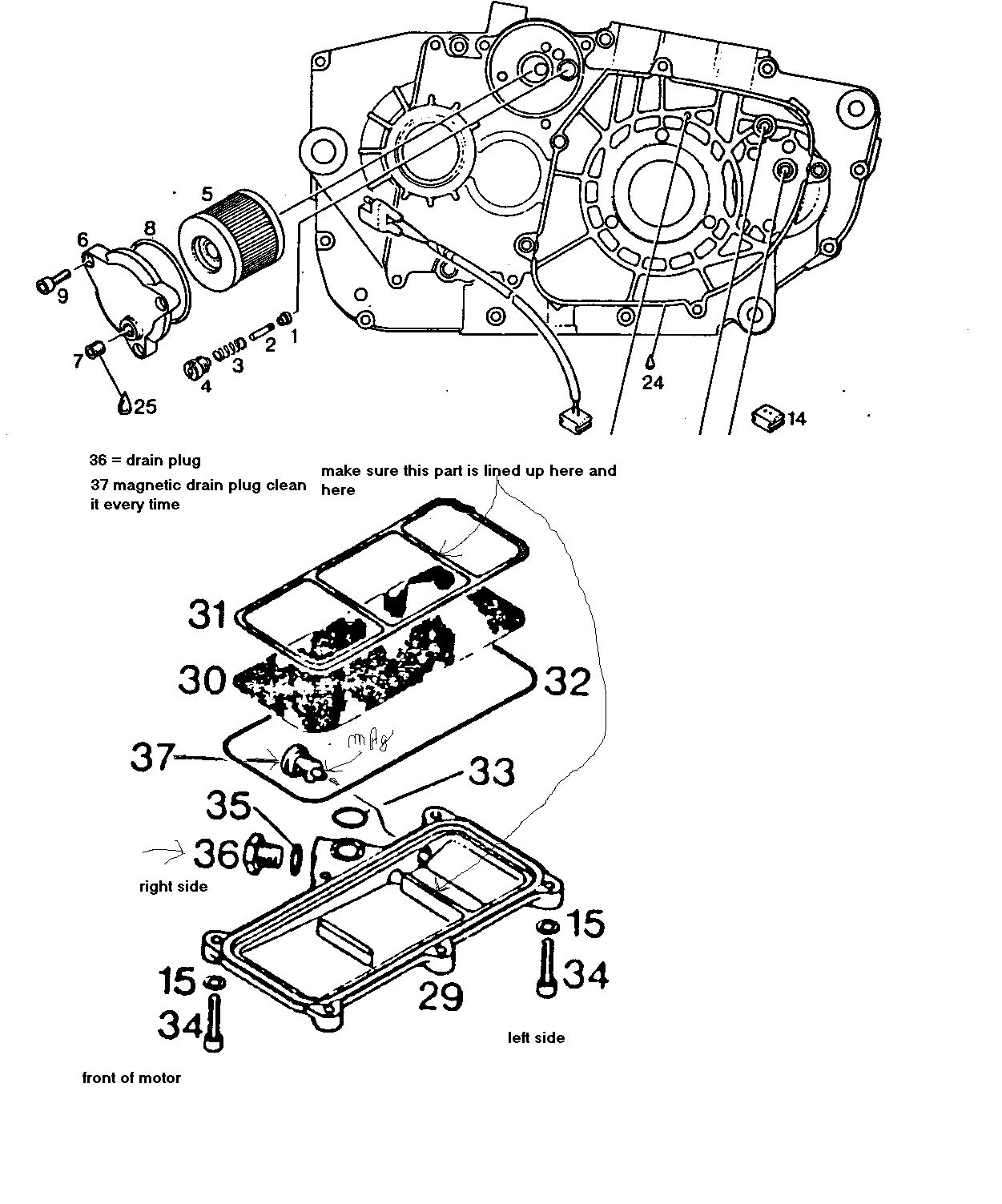

HAD MINE A YEAR AND A HALF THIS WAS FUN THE FIRST TIME :smt040
Oil change rotax motor
Take a siphon hose and remove all the oil from the Main tank in the frame by way of the dipstick hole
This reduces the amount you will spill later… :-D
The oil filter is K&N 151 same as BMW f650
It is located on the right side behind the plastic Cover over the front chain sprocket
It is a lot of fun to remove …Once you have the chain cover off it will be
Easy to find the filter cover
The oil drains are 36 and 37 in the picture and are on the
Right side of the bike on the oil pan… MAKE SURE you clean the magnetic plug 37
I only remove the oil pan every other oil change
If the engine history is unknown Do IT
You will not get much out of lower end…The oil is in the frame tube tank
The lower case fill plug is on the left about 4 inches behind the
Clutch cable where it enters the left case (move the kicker it blocks the view) 8mm Allen I think
When refilling about ½ quart goes in here
To completely drain the Frame oil tank you must remove
The large bolt that is on the hose to the engine at the rear
Of the frame backbone
This is the reason to siphon the tank … so the mess is not as big
This engine is the biggest mess to change oil in of any bike I have ever worked on
its not hard to do the oil change …but wait till you start the mess cleanup
One half quart in lower case 2quarts in frame back bone
run engine and top up as needed
3 qt should do it
DO CHECK EVERY THING BEFORE STARTING MOTOR
This is a good time to check the chain before putting the cover back

see pictures in this post
IF YOU SEE A MISTAKE EMAIL ME ASAP
this is based on a 1995 504E motor
CLICK ON THE BELOW PICTURES TO SEE A FULL VIEW
ROTAXOILCHANGE rotaxoilchange
picture of drain and fill locations
oil change ref....
rotax oil change 1.JPG (233.85 KiB) Viewed 10429 times
