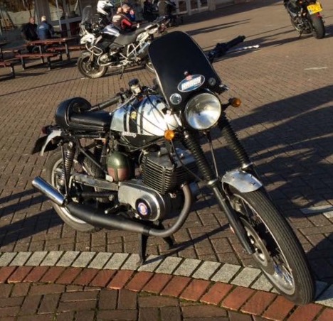

the ETZ is good for 80mph as std I just made mine look faster...I have a Taiwanese piston still with three rings but the top haven't come off yet despite repeated 8000 rpm forays in the lower gears
