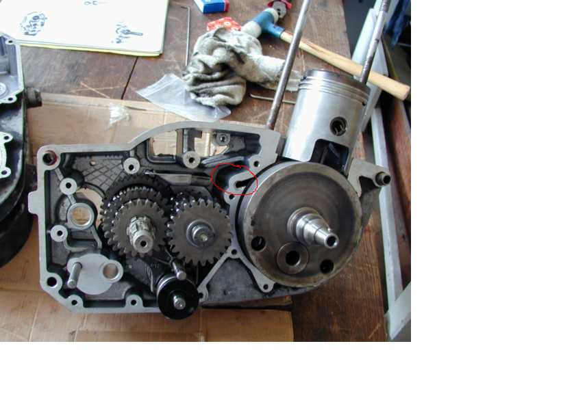

Postby den » Wed May 27, 2015 9:12 am
i had the same problem with a honda 125 , its totally different but the mistake could still be the same,The Gasket i used for the two halves of the engine was for the right engine but wrong export model , it looked identical but had one little difference,,it left an oil gallery wide open and oil would be pumped into the airbox,
ive looked at your engine split and can see where there may be a problem for you..apart from the seals the only other place is here,, circled,,could be a idea,
also just check your airbox , oil could be flowing back through the carbs,thats how i found out in my case
