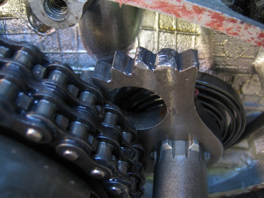

Swarf in the oil could just be kickstarter-quadrant teeth - was with mine, the quadrant alignment is not exactly brilliant - see download/file.php?id=3446&mode=view

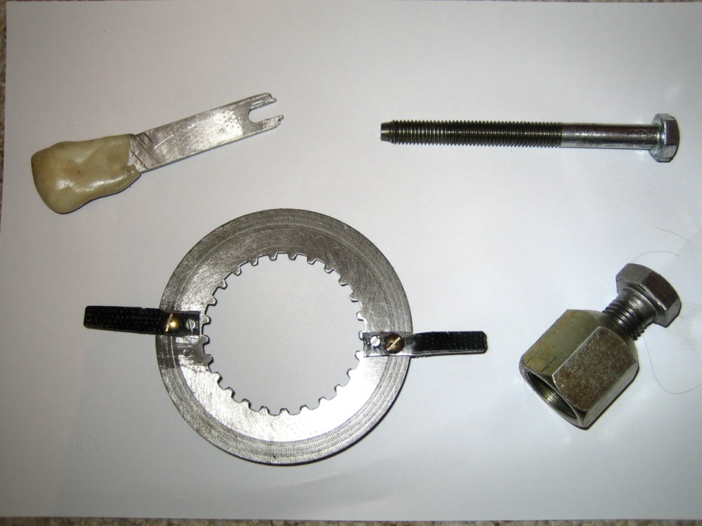

Check the clutch-side stuff first, because you can do that without cracking the case. You'll probably need an impact driver to get the clutch-cover screws out, though. And a new clutch-side gasket. I have a stencil if you're feeling brave and want to make your own from gasket paper.
As for taking the rotor off - yes, it's an M10 bolt, but file down the last few turns, otherwise you risk damaging the crankshaft inner threads where the points-cam bolt goes. The rotor is a taper-fit on the crankshaft with a Woodruff key, which (given the age of these things) will probably be stuck firmly in the crankshaft keyway.
Your TS is a later model, I think, so your primary sprocket will be the threaded-and-tapered duplex rather than the "two-screws" simplex as shown in the manual. You can use the claw puller, but a screw-on popper is better. You'll also have to take the clutch off, which means you'll need a spring-pusher (brace the bike against a wall, and put a sheet up behind you to catch the spring-cups). You'll also need a clutch basket stop. I made my own out of an old driven plate and some scrap steel rebar. See attached photograph - the diagrams in the manual are a bit hard to read because of the scan quality.

Behind the rotor is the crankshaft which has a tapped hole for the points-cam bolt - filing down the M10 means that you'll be pushing against the inner, rather than the outer part of this threaded hole. Doesn't really matter much, to be honest - as long as you don't have a bolt with a ragged end, you won't damage the very tough crankshaft metal.
Just keep winding the M10 in until the rotor pops loose - the rotor shouldn't be stuck hard to the shaft, but the Woodruff key might be. By the way, the inner of the rotor is also threaded, so once it's free, just pick it up by the M10 bolt. Hopefully you'll have remembered to take the stator/points assembly off beforehand, remembering to disconnect the electrical connections and being careful not to smash the regulator resistor with the socket wrench like I did :twisted:

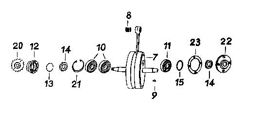

Postby therealche » Sun Apr 12, 2015 8:57 am
It's OK not to have a woodruff key. Here is a picture from a parts list from some time post 76
Which shows no key.
The crankshaft bearings do tend to stay on the crank. There is a clever tool for removing them.This is a cheap and easily bought one
http://www.screwfix.com/p/bearing-separator-puller/19315?kpid=19315&cm_mmc=Google-_-Product%20Listing%20Ads-_-Sales%20Tracking-_-sales%20tracking%20url&kpid=19315&cm_mmc=Google-_-Shopping%20-%20Car%20and%20Van-_-Shopping%20-%20Car%20and%20Van&gclid=CP-Ys8318MQCFYbItAodfB0AJw
, I tend to slide a cold chisel under the edge of the bearing and give it a light tap, then the other side and repeat until there is enough clearance to use a three legged puller to pull it off. Sounds brutal but it has always worked for me
