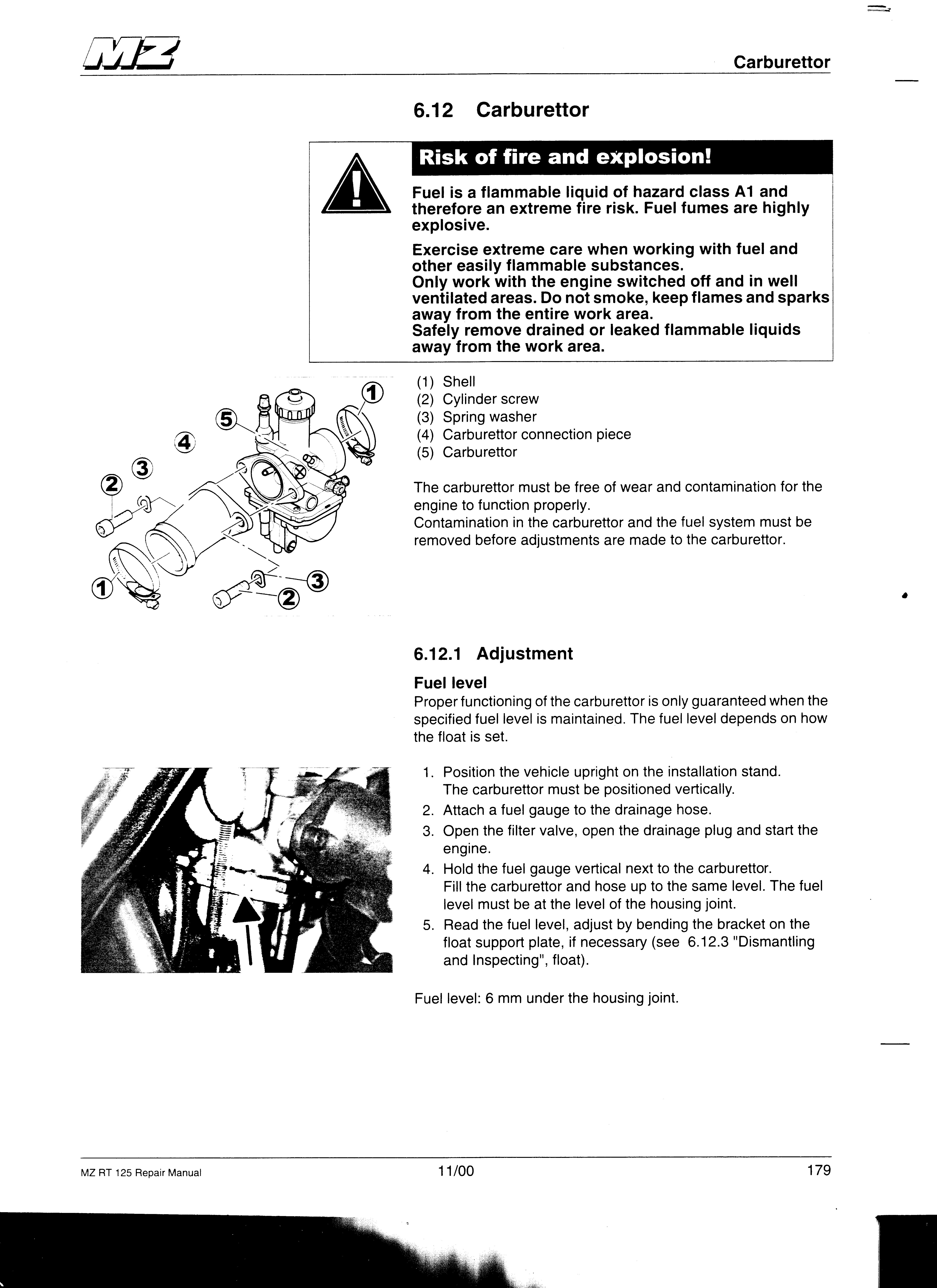

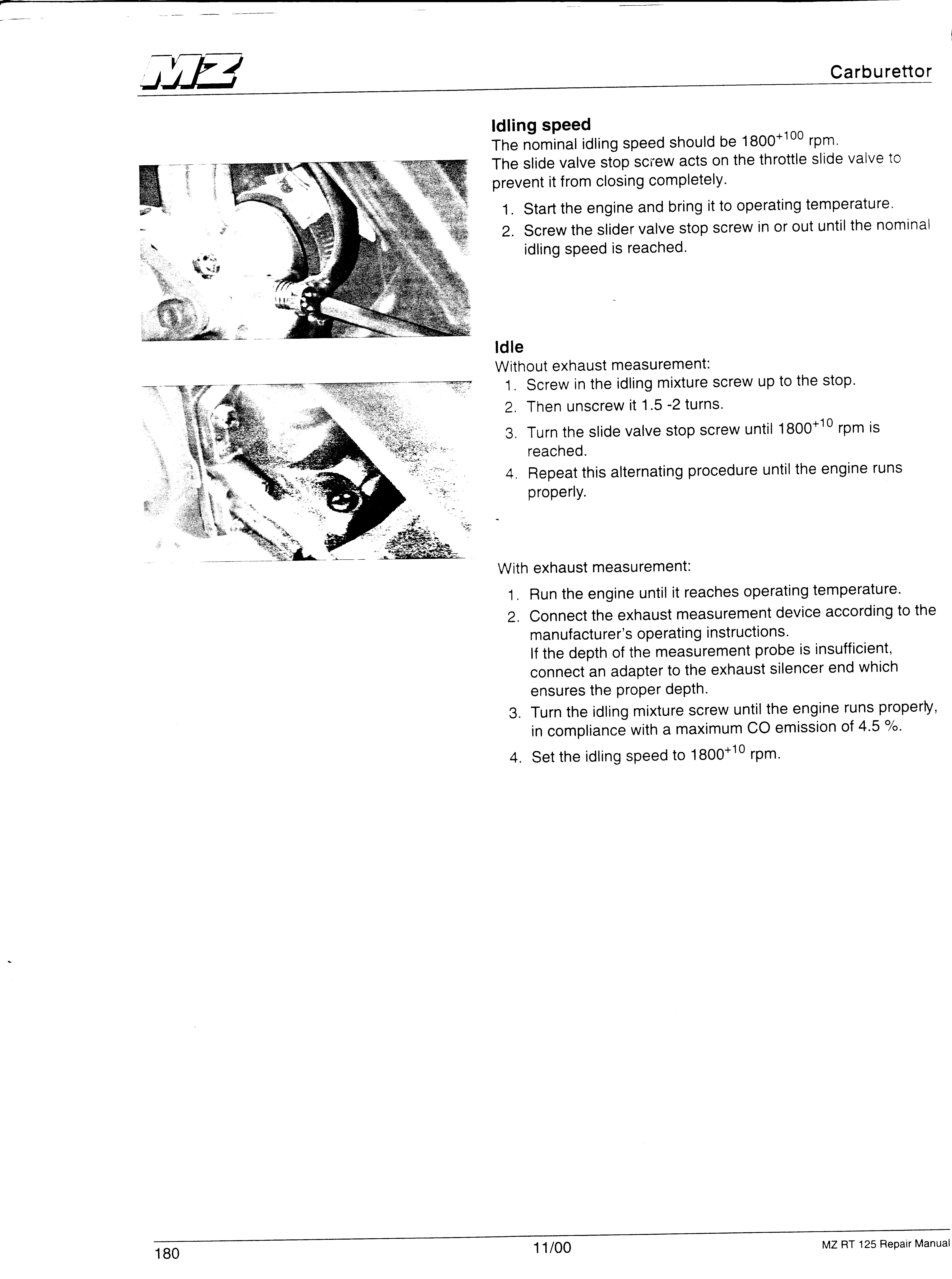

I was hoping someone could tell me the carb screw settings please. For idle and mixture screw please.

here are shop manual pages
i did this on a 15 year old computer it took bloody forever
i do need to move some files to the new one
click on page to make bigger
right click and save or print
