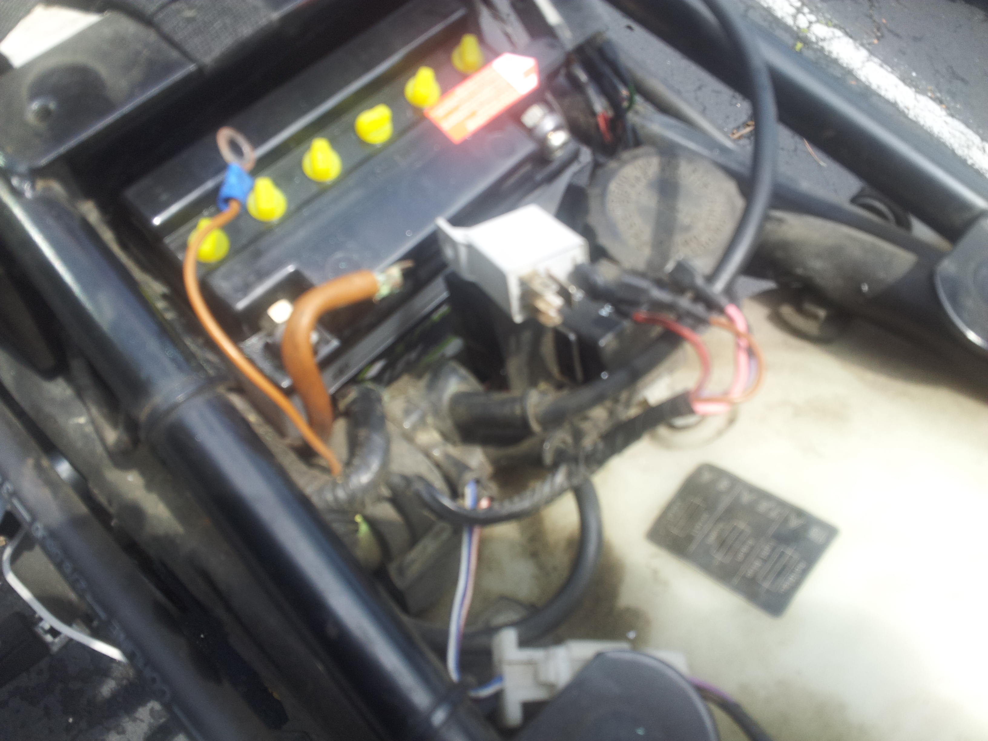

Postby Nozz » Sat Jun 13, 2015 11:53 am
I am still wrangling with this thing. The battery was dead, so I charged it, no good, but it turned a bit, then I think I may have the wires crossed on this relay, when I turn the key on, it tried to turn, with out the start button being pushed. Now I have a new battery, but it blows the 10A fuse any way I try it. Can one of you send me a picture of the correct wiring for this relay? Thanks!

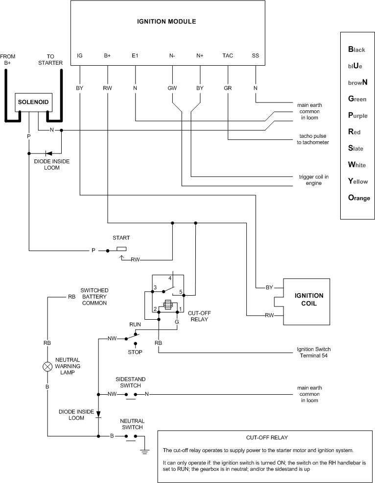

Postby DAVID THOMPSON » Sat Jun 13, 2015 4:55 pm
here is relay wiring
relay19 relay30 ((click on jump to post at far right of the page when you find this with search))

Postby Nozz » Mon Jun 15, 2015 7:44 pm
OK, I finally got back to looking at this again with the schematic. The problem child relay is NOT the same as the cutoff relay illustrated. That one is on the right side of the frame and is all connected as shown. This is right in the middle by the fuse box and has a RB wire on spade 3. The other wires are brown, purple and pink (red?). Is there another illustration of that one? I did find a replacement relay, but I think I just need the correct terminals/colors. Thanks!

Postby DAVID THOMPSON » Mon Jun 15, 2015 8:20 pm
r/b is plus voltage pin 3 pin 5 is output with relay powered
pin 4 is powered with relay off
pin 1 is plus same as 3 and 2 is grounded to turn relay on
think this may shut off head lamp when starter is cranking
i am looking for drawings and bike is parked in part of basement with no lights
so will look at the mess under the seat tuesday some time
and edit this note
not worked on the bikes in a bit and need to sort out whats going on in the circut
Re: Skorpion -sat too long, won't start
Postby Nozz » Mon Jun 15, 2015 9:29 pm
Good news at last. I googled the schematic, found the darn thing in German, translated the colors, Red Black is Rot Schwartz or Ro Sch for short. The relay I was dinking around with was fine, just cross wired. The cutoff relay you all were talking about was indeed the problem, at least the rusted spade. I replaced it with the one I bought and it fired right up. Now onto getting it kind of back in shape. Thanks for your help! Next subject. What to do about a worn out fit of the muffler can to the pipe. Rattles. Need to shrink one or squeeze down the other, or shim it. Suggestions?
