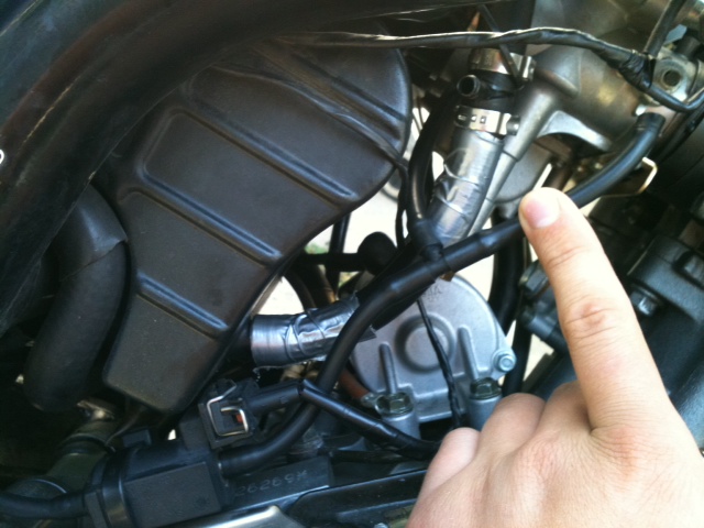

Postby Antrap9 » Thu Jul 10, 2014 1:33 pm
Cleaned and reinstalled carbs. Original problem is now solved; motorcycle throttles without stalling, however will now stall when choke is turned off. Does this mean I'm running too lean? I am also worried I missed something upon reinstallation, noticed air escaping from a valve on the breather hose...
