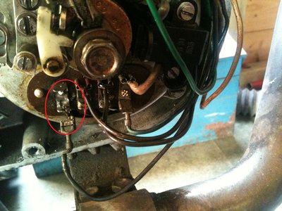

Postby Inverlew » Wed Jul 09, 2014 2:30 pm
This is the broken connection, any suggestions? The connector is loose on the backing plate.

Postby therealche » Fri Jul 11, 2014 9:43 am
OK that's one of the Alternator stator connections. I would first suggest checking the phases. If memory serves, you want to check the continuity between the 3 terminals ( 1&2 2&3 and 1&3) if you have a multimeter they should all be around the same figure. and make sure none of the terminals short out to ground. If all seems OK I would be tempted just to clean up round the terminal plate and work some araldite ( other epoxy adhesives are available) into any gap. Change the blade on the wire, and you should be good to go
IF you want to replace the connector plate it is available from Germany but P&P is often a killer
http://www.ost2rad.com/MZ-Spare-Parts/Electrical-equipment-Battery/Connecting-plate-8046-2-221-for-stator-housing-MZ-ETZ.html
http://www.mzsimson.de/index.php/eng/_/_/_/_/sidab2d6edde21bdd608f9c7daba37d28f7/?_ ( Guesi is a member on this forum)
Also worth contacting http://www.themzshop.co.uk/ see if they have one, or can get one.
Then you have to work out how to get the old one off, and re-rivet the new one
