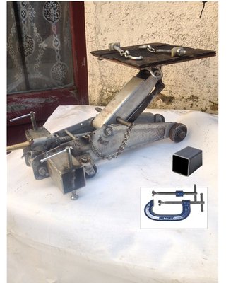

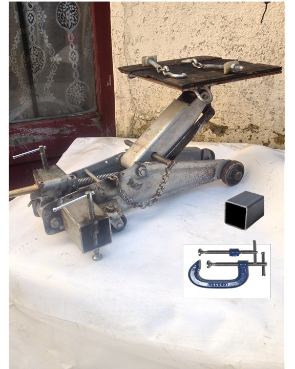

So heres my hydraulic bike lift, As you can see its made from an old car jack, new ones can be bought for £25,motorbike lifts can be bought for £90,i welded a square plate on top and added some loops on the side and front to lock the bike down via the foot pegs,,thats what the hooks and threaded bar resting on the top plate are for , for security i drilled a hole in the sides and added a removable pin to allow the jack to be released of pressure yet the bike still be off ground,,the chains there so i don't lose it ,the extra outriggers are made up of 1.5 mill box section and the windable adjusters and made from cut up G clamps..study the photo and make one yourself,,
