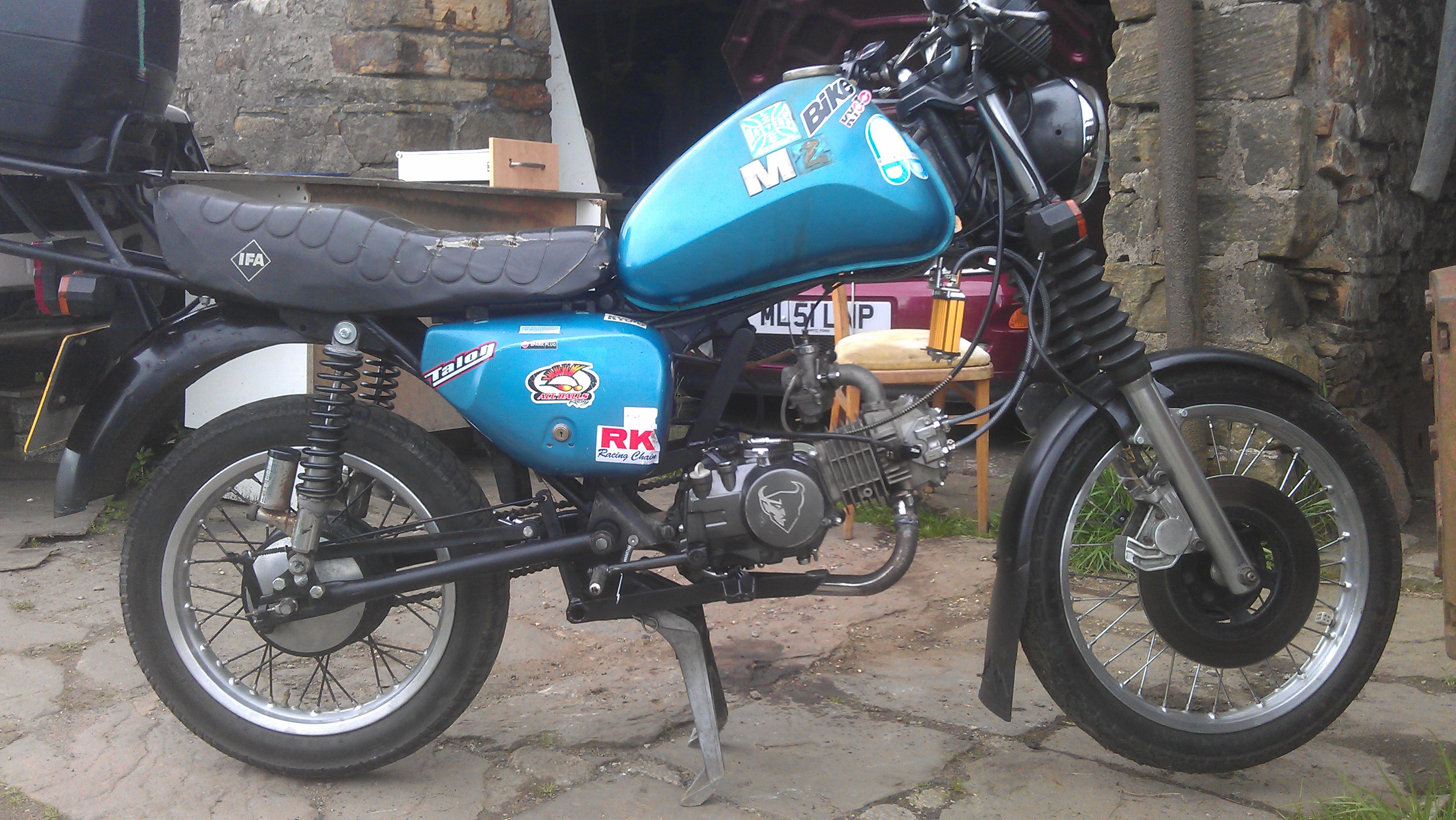

the mzonda lives.
the mzonda lives.
Postby craiggor » Tue May 27, 2014 3:33 pm
yx 140
craiggor
Posts: 22
Joined: Sun Apr 21, 2013 7:15 am
Location: bury
Re: the mzonda lives.
Postby DAVID THOMPSON » Tue May 27, 2014 5:44 pm
excellent use of a pit bike motor

Now that's a interesting MZ version, plenty of space even to cable tie a second one it to form a v twin!!

tigraft, I can only dream.Allan millyard's work is outstanding.dave I like the motopeds but like a grom a bit to expensive for me.

lol nope… it needs built i stripped it and its sat in boxes… mind you a honda 90 motor can be rebuilt in a couple of hours… done many of them in my time… my idea for it was to fit a 110cc top end. and put it into a pit bike frame reworked to make a BSA Bantam'esqe special.. with 17" wheels kinda like those motopeds.. but old school.. no plastic all metal, looking like a lightweight from the 30 to the 50s

great idea.you can get a 17" pit bike front wheel cheap nowadays.you would have to make a back one.I got my pit bike engine off my mate who used to race them in the fab championship.it started smoking and he was told to get a new piston and rings he did.but when I opened it up there was nothing wrong.I said it could be valve seals.by this time he had bought another bike.he has now moved on to mini moto sidecars and sold the pit bike and I got his old engine.new valve seals and the smoke is gone.
