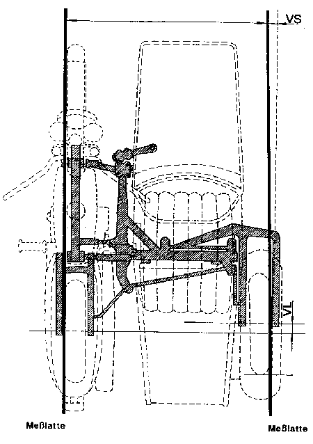

They all do that Sir! Usually you can accelerate through it but sometimes it can be nasty!. Does the bike have a steering damper? If so screw it down to make the steering stiffer. If not you need one! Probably worth checking the alignment of the sidecar
Where VS = 30-50mm
