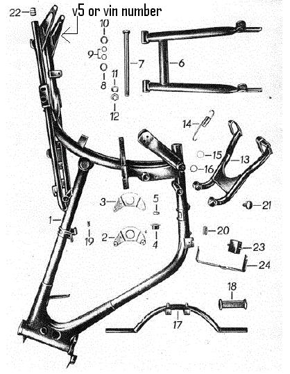

Postby DAVID THOMPSON » Tue Apr 15, 2014 11:16 am
also look here
http://www.themzshop.co.uk/category/frame-swing-arm_jw/
find the number for part 22 on the picture top left of pic
it should be on one of the frame lugs near the 22
right side i think
top left of picture

Thank you both. That is the last place I would have thought of looking!
