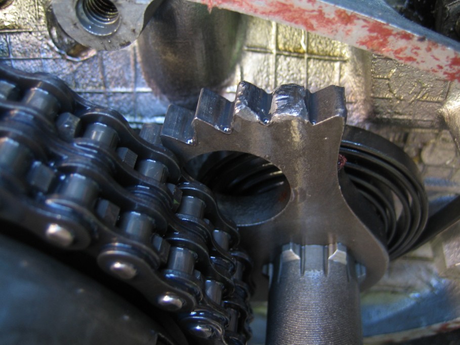

When I took off the left-side cover, I saw the first two teeth of the kickstart quadrant gear have been ground off, unintentionally. This explains why my kickstart would sometimes 'jam' and not engage the engine. Is it possible to either file them down smooth and get away with fewer teeth, or if not, can I replace the quadrant without taking the clutch off? Or should I just buy a clutch-puller and stop worrying about my crankshaft?

A picture of the kickstart quadrant might help, not done many of the small engines but have an idea that a tooth or two are "relieved" on the quadrant

As for the kickstart, see attached photo. The 2nd and 3rd quadrant teeth have been rounded off almost totally, the others seem okay and it still engages the engine. Can't see any obvious damage to the driven sprocket, so hopefully unless it jams, no trouble. Might be worth cleaning the teeth off completely, though, so they can't accidentally catch/jam.

Postby den » Sat Sep 21, 2013 5:32 am
why not build the damage up with weld and grind yourself new teeth,

[Don't have a MIG/TIG/Buzz-box to hand, and was never much good at it anyway - for now, the kickstart engages and doesn't jam most of the time, so that's fine.]
