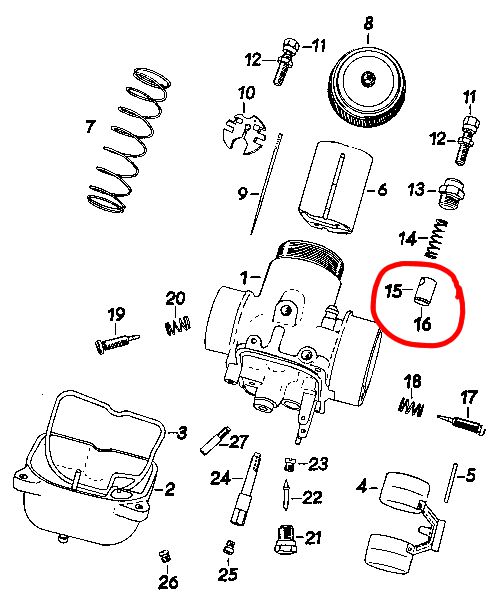

Postby arry_b » Fri Aug 16, 2013 12:06 pm
Choke bung not sealing properly. The over rich mixture kills the plug.
I bought a 1994 301 with the same problem. £5 spent on a new bung and a plug and it took me touring in France.

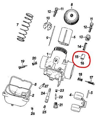

Postby therealche » Sat Aug 17, 2013 4:29 pm
So part 16 ( a rubber washer) has a habit of dropping off part 15 ( brass......thing!) and blocking the starter circuit in the carb. So the engine is runs very rich

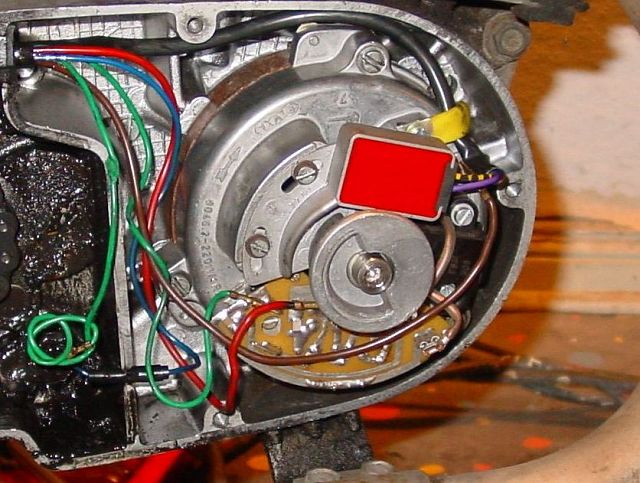

Postby therealche » Sat Aug 24, 2013 6:07 am
Yes that's the neutral switch. Unlike modern complicated bikes, all it does is make the neutral light work. Now send us a picture of the generator ignition set up!
therealche
Posts: 702

Re: Dead MZ 300
Postby therealche » Sat Aug 24, 2013 2:43 pm
Its the other bit on that side which may or may not look like this
