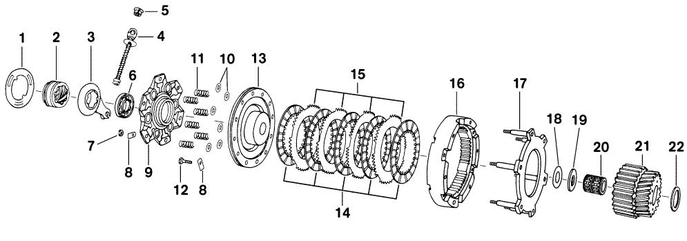

sounds like the clutch basket may have lost some fingers ( the tabs that rub against the clutch plates)
after looking this is different than i am used to seeing
item 17 the studs hold it together along with i think item 7 a nut
if one of those studs cames loose
you have a problem as it compresses the springs
it appears to be a simple engine and clutch
a fast strip down may give you time to get parts saturday

I've got bad news i'm afraid. It turns out that the big clunk i heard was actually one of the chain adjusters at the back saying goodbye in dramatic fashion. This is good news as it means the clutch is fine (this is confirmed this weekend). However when taking the left hand clutch cover off, some idiot (me) may have chipped a bit of aluminium off the inside casing. It's not a large piece and as far as i can see not structural. Is there any way these can be patched/mended?
