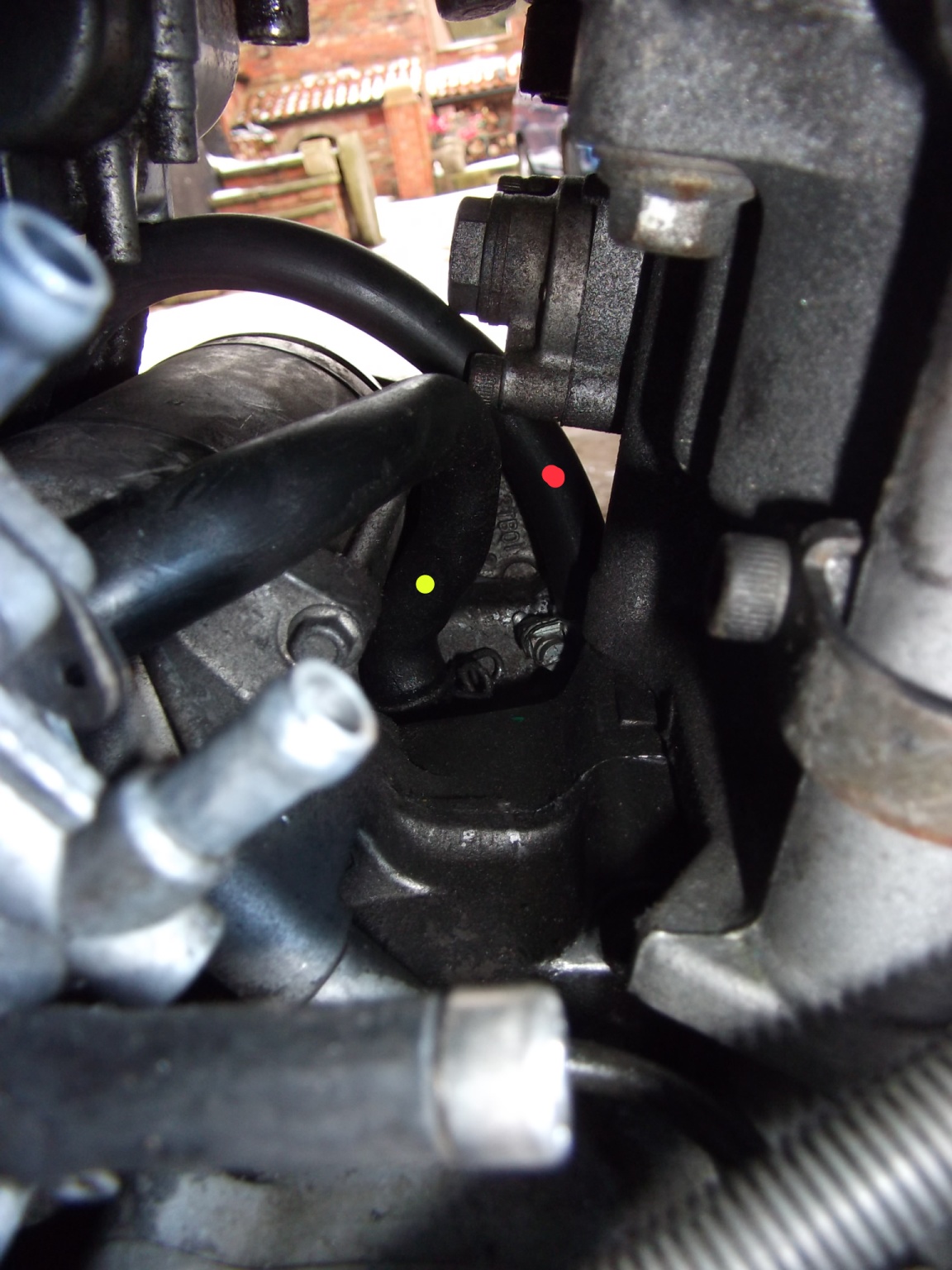

Postby Windmill » Thu Jan 24, 2013 6:10 am
Yes, still easy. I've marked the pipes in the photo, red is the front one/to oil tank connection I was talking about, yellow is to the airbox. I actually had that one off too as the clip wasn't on correctly. Same applies although I replaced the spring clip with a jubilee clip on the front one. Hope that helps and disregard the coarse filter comment.......... :roll:
