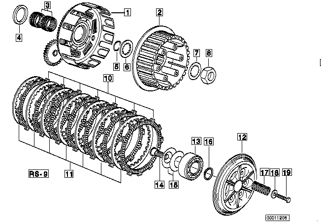

you know the clutch baskets lid ,the part that accepts the clutch springs and is actuated by the clutch lever rod??..
have you lined the arrows up,,youll know when its right because it drops in that litle bit further(5mm),
although it look isometrical ,there is a wrong and right way it slots in , The wrong way will lock the clutch.
see item number 12 in photo
