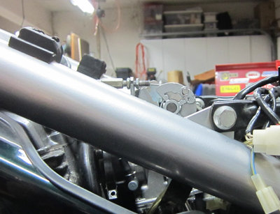

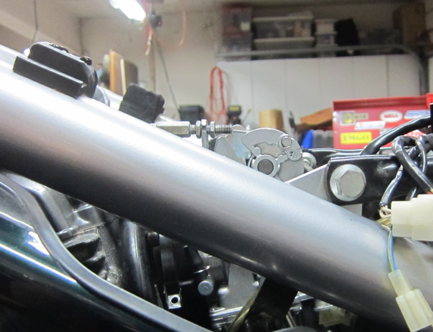

First pic shows the cable mount as delivered (click to enlarge):

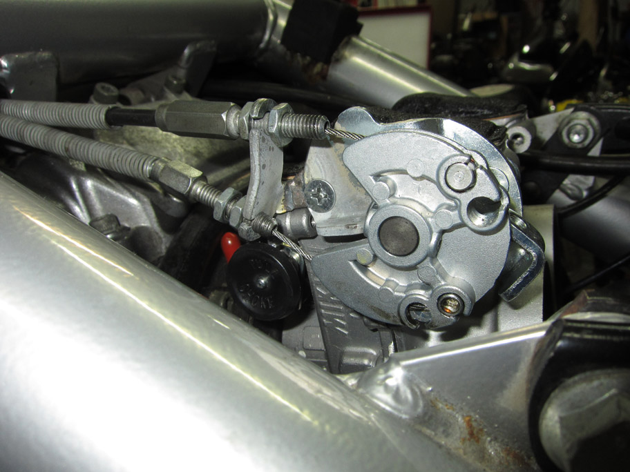

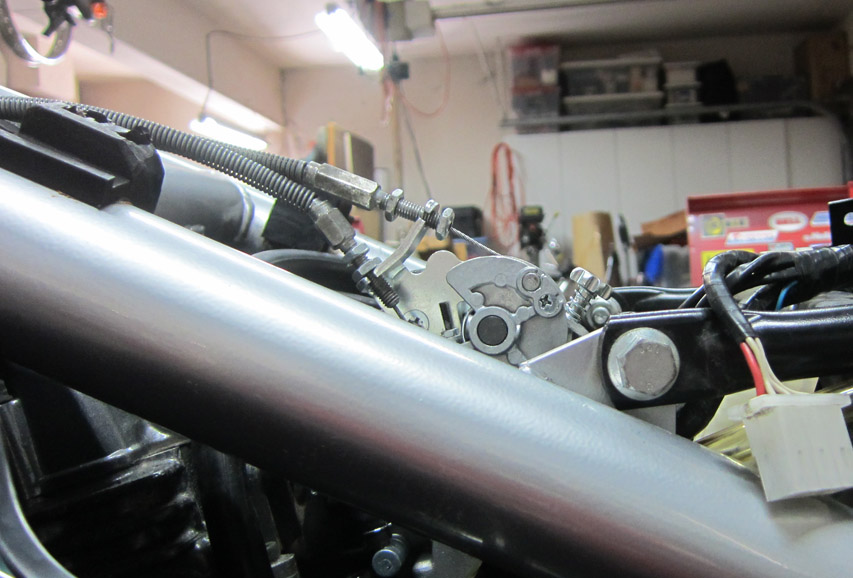

Second pic shows new cable routing:
And now for the closeup - took my friend less than a minute, using TIG. He put a nice inside radius at the weld, I did not have to grind or sand it at all.

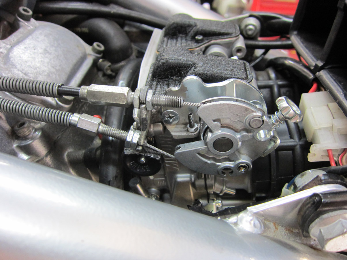

Here's the new top view:

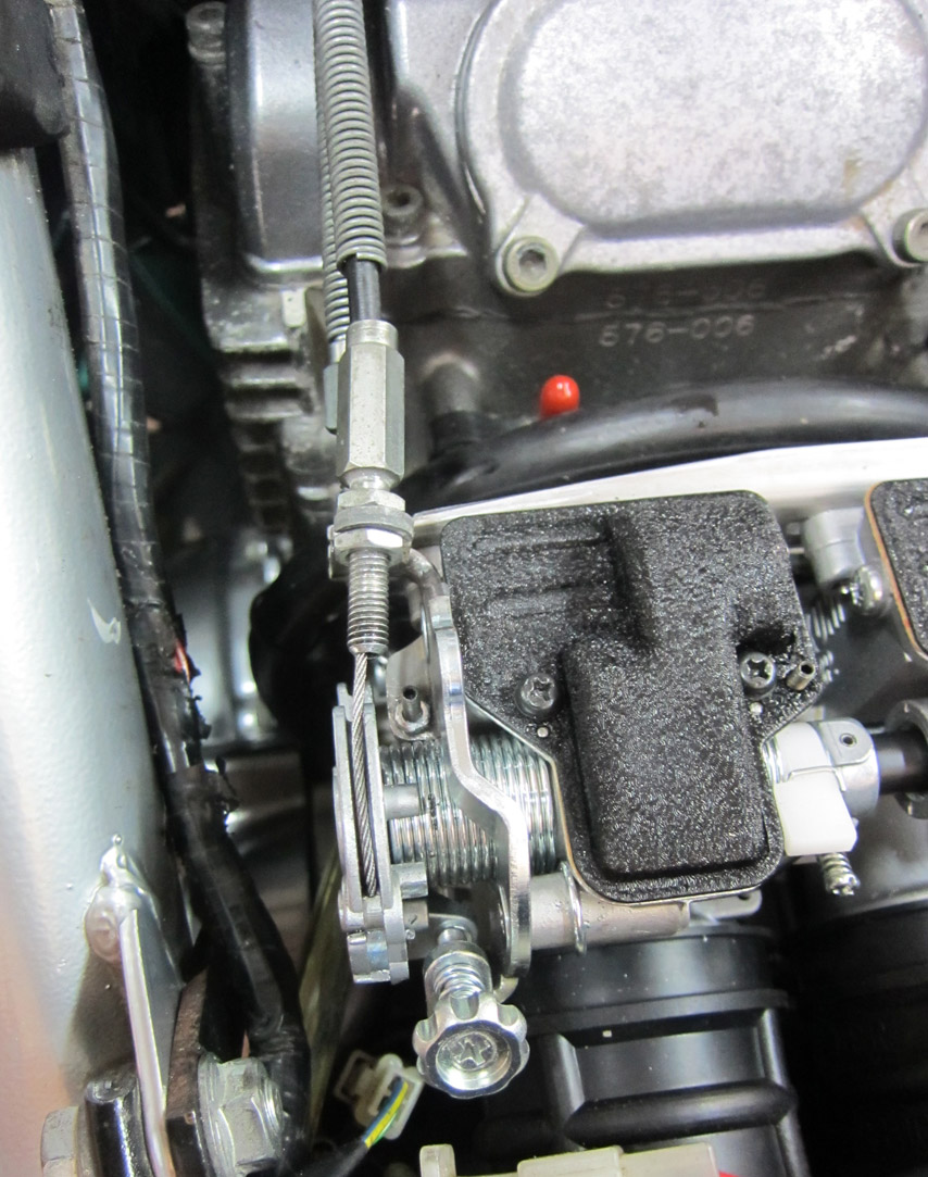

And the new side view:
