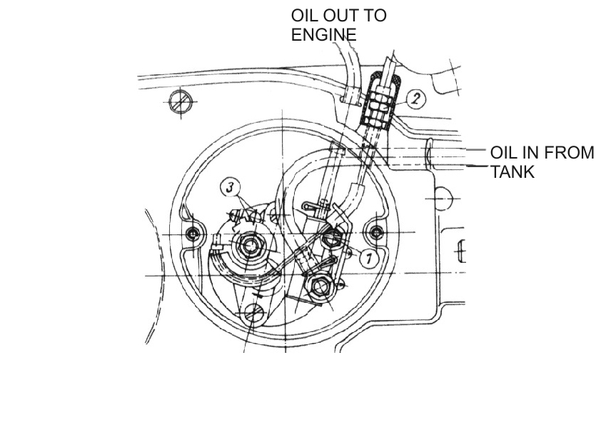

Postby tony211289 » Sun Sep 09, 2012 11:10 am
Took all the panels off like 3 months ago nd now iv sorta forgot where one thing goes.
The 2t oil reservoir pipe...I sorta forgot where it connects back on the bike.
can any one explain to where in connects?
thanks guys

Is this the pipe that comes out of the bottom of the oil tank at the back? If so it goes into the Mikuni oil pump that is situated behind a round aluminium plate with 2 screws in it (on the left side of the engine). If you go on youtube and look at some of the MZ factory video's there may be a clue in them.

thanks David. Yeah i think iv found it. There's a pipe that seems to be running to the bottom end of the engine, im sure that's the one that gets the 2T fed through it

Pipe from 2T tank goes into primary case, think its just in front of kickstart
Oops ignore me I'm thinking of the 250!

The 125 setup is similar to that shown above. It is on the left hand side of the engine, below a round cover, but it's towards the front rather than the back, because the pump is driven by the end of the crankshaft, instead of the gearbox mainshaft on the 250. I think on the 125 the cover has MZ written on it.
The manual shows the pipe from the oil tank entering the pump's chamber at the bottom, towards the back. Pretty much directly opposite the cable.
I do have a picture which shows it better but I'm afraid I'm using the forum on my phone and it's beyond me!
