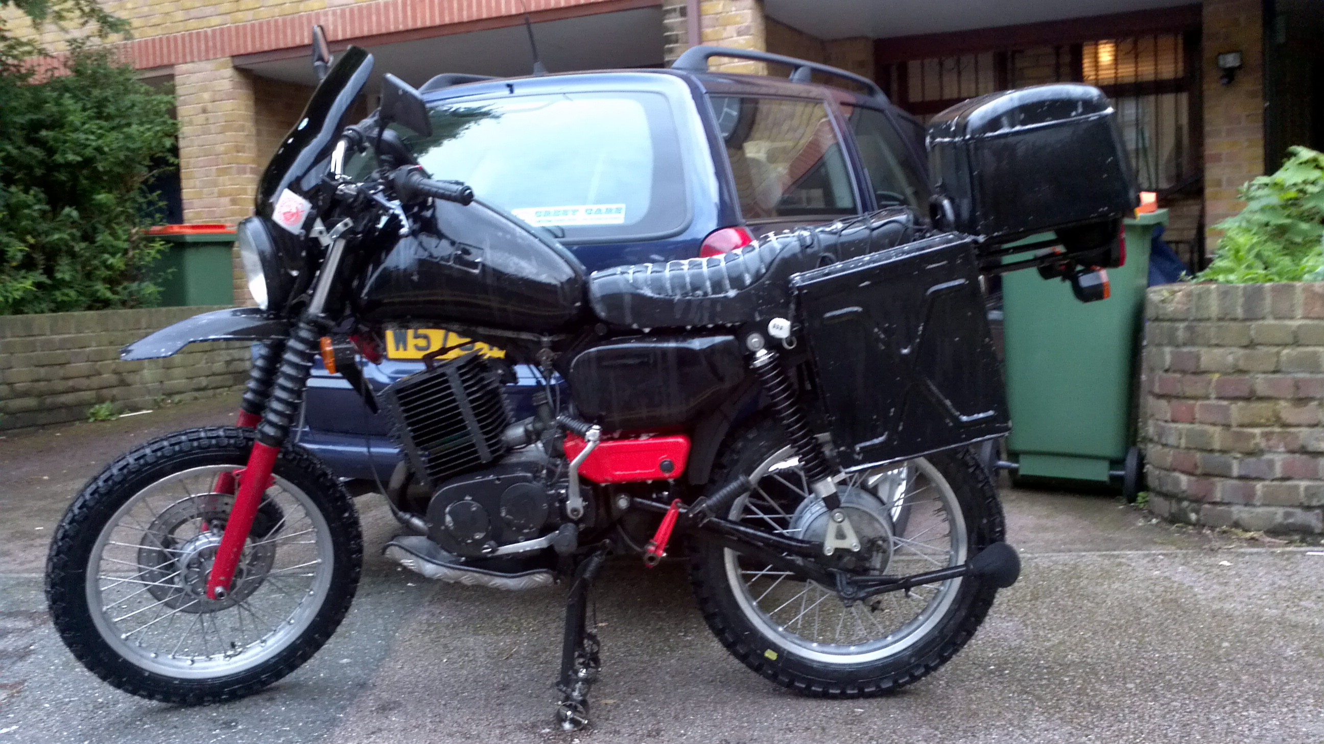

One thing i think may be causing the problem is i have a bigger rear wheel and a 2" lift that tips the whole of the bike forward (see pic). Could that mean the clutch is sitting in more oil than it is expecting and is swelling when stood?

Postby thomaskwscott » Thu Jul 12, 2012 9:51 am
its EP80 gear oil.
This problem is fixed now by the way. Muggins here massively overfilled the bike with oil, i have drained the excess off and it's great now.
